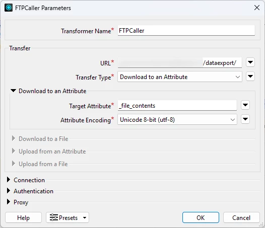

I need, starting from list of thousands of filenames, verify if these files exist in a FTP site. I think this could be achived using an FTPCaller, but at the cost of downloading each file, resulting in significant bandwidth usage and deterioration in performance.
Can anybody suggest a better solution?
Thanks!
nielsgerrits
VIP
Forum|alt.badge.img+67

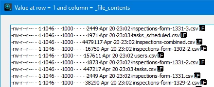

If you choose Download to an Attribute and not address a file but a folder it will download a list of items in the folder, not the files.
