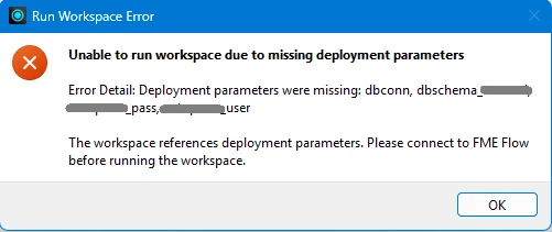

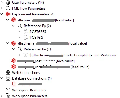

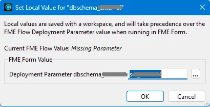

I’m authoring some workspaces for operating in FME Flow Hosted and I’ve configured some deployment parameters for DB connections and text values. Now because it’s a Hosted service, I don’t need to keep an FME Flow instance running while I’m authoring. From FME Form, it looks like local values are set, but I can’t seem to get the workspace to run without syncing to Flow.
Why isn’t Form recognizing the local values? I seem to remember in previous versions that I wouldn’t need to create user parameters just to assign to deployment parameters for offline runs. That seems redundant. What am I missing?
I’m on FME Form 2026.1.1.

All the right points, which is why this is confusing.
For the local values with text type, “dbschema”, “user”, there IS a value set locally, but the parameter itself still isn’t resolved.
And for “dbconn”, I DO have the same connection name in Form and it DOES resolve when assigned.
It would make sense if the deployment parameter icons stay red, but I should be able to run the workspace, but I can’t.
