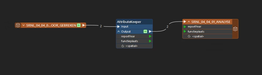

I have an issue with a working workspace that has run for a couple years now. Recently, since 28/5 I have issues with writing integer values.
What I’m trying to do:
Insert point features into an existing ArcGIS Online hosted feature layer using the Esri ArcGIS Feature Service writer. Integer attributes (e.g. reportYear, equipmentNr) should be written with their actual values, e.g. 2026 / 2027.
What happens:
Every integer field is written as 1 in the target layer, regardless of the source value. In the Data Preview right before the writer the values are correct (reportYear = 2026 / 2027). After the insert, the integer fields all show 1. I reduced this to a minimal workspace (reader -> AttributeKeeper keeping only the integer attributes -> writer) and it still happens.

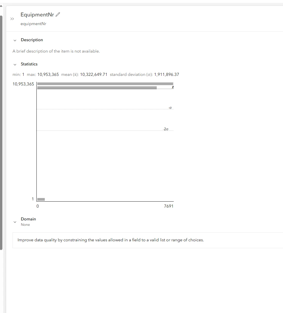

Please check the existing feature layer to see if there are any data ranges set on the integer attributes: https://doc.arcgis.com/en/arcgis-online/manage-data/define-attribute-lists-and-ranges.htm
thanks ​@daveatsafe didn't look at that one, but it's also empty.
the definition is:
"name" : "equipmentNr",
"type" : "esriFieldTypeInteger",
"alias" : "EquipmentNr",
"sqlType" : "sqlTypeOther",
"nullable" : true,
"editable" : true,
"domain" : null,
"defaultValue" : null

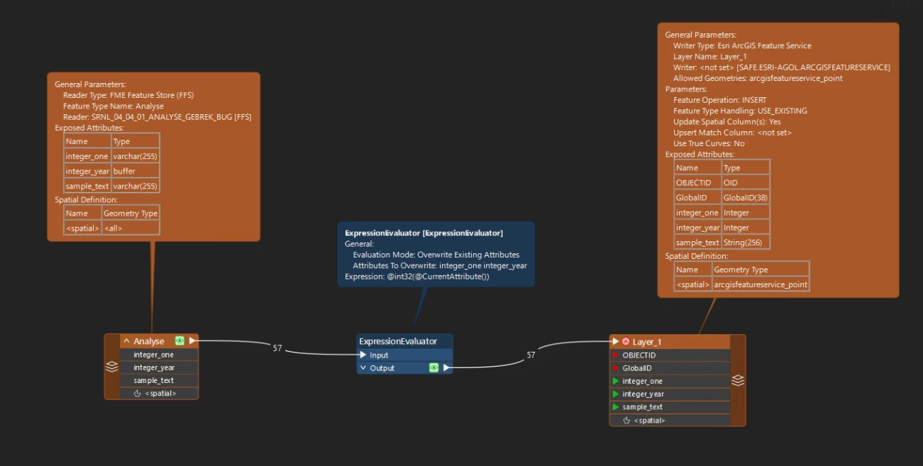

I think I found a workaround with the ExpressionEvaluator right now.
It wrote the integers successfully.

I was able to reproduce the problem by forcing the values to strings, and will create a problem report for our development team.

Thanks ​@daveatsafe - will start implementing this workaround to production now :)
