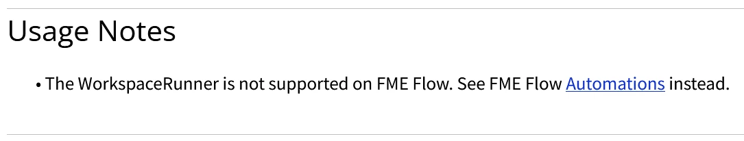

You should not use the WorkspaceRunner on FME Flow, it’s not supported. From the manual:
Use the FMEFlowJobSubmitter in stead.
