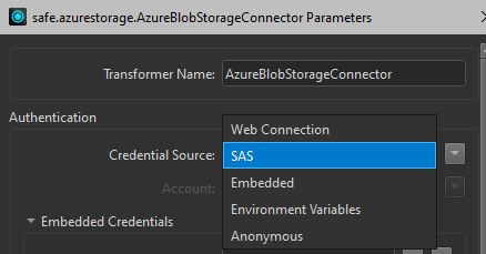

Hello,
The documentation and this community thread indicate that “Default Azure Credential” should be an option under Authentication → Credential Source for the AzureBlobStorageConnector transformer. I don’t see this option, either in FME Form 2023.2 or 2024.2.3.
Am I missing something, or is this a bug?
Thanks,
Graeme

Hello ​@graemebrown,
Thanks for posting your question. Checked this on my end and “Default Azure Credential” is visible. Have you tried uninstalling the transformer via Tools > FME Options > FME Packages and reinstalling it?
Thanks!

Hi ​@AliAtSafe,
That worked! Thank you for the suggestion. I wasn’t aware that my transformer was out of date, and didn’t know to check for that.
Graeme
