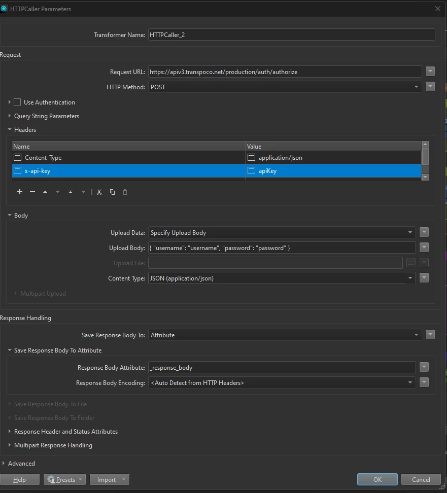

I’m using an API (https://docs.transpoco.net/?version=latest#52611862-77b1-4fe6-8a1d-67fc4904cb54) and need to send a post request for authentication. The issue is that the post request takes the username and passwork on the body of the request as a JSON.
Any ideas of how I can create a webconnection to run this request in a way i can safely store the credentials on the webconnection instead of on the httpCaller transformer?

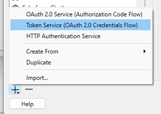

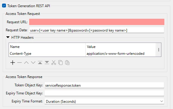

Have you tried creating a custom Token Auth Service?
Creating a Token based Web Service in FME - Yelp – FME Support Center
It looks like this might be able to achieve what you’re after
The auth endpoint for the docs would be the request url, with the credentials specified in the header. you then look to be able to extract that token, and specify how it is then injected into a call using that web connection
