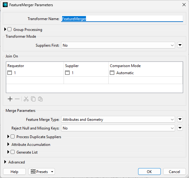

Use a FeatureMerger with the Requestor input port getting the data from your Esri SHP file points and the Supplier input port getting data from the Collada input fme feature type. You can simply set the join on a constant value like “1” for both Requestor and Supplier instead of an attribute in the FeatureMerger.

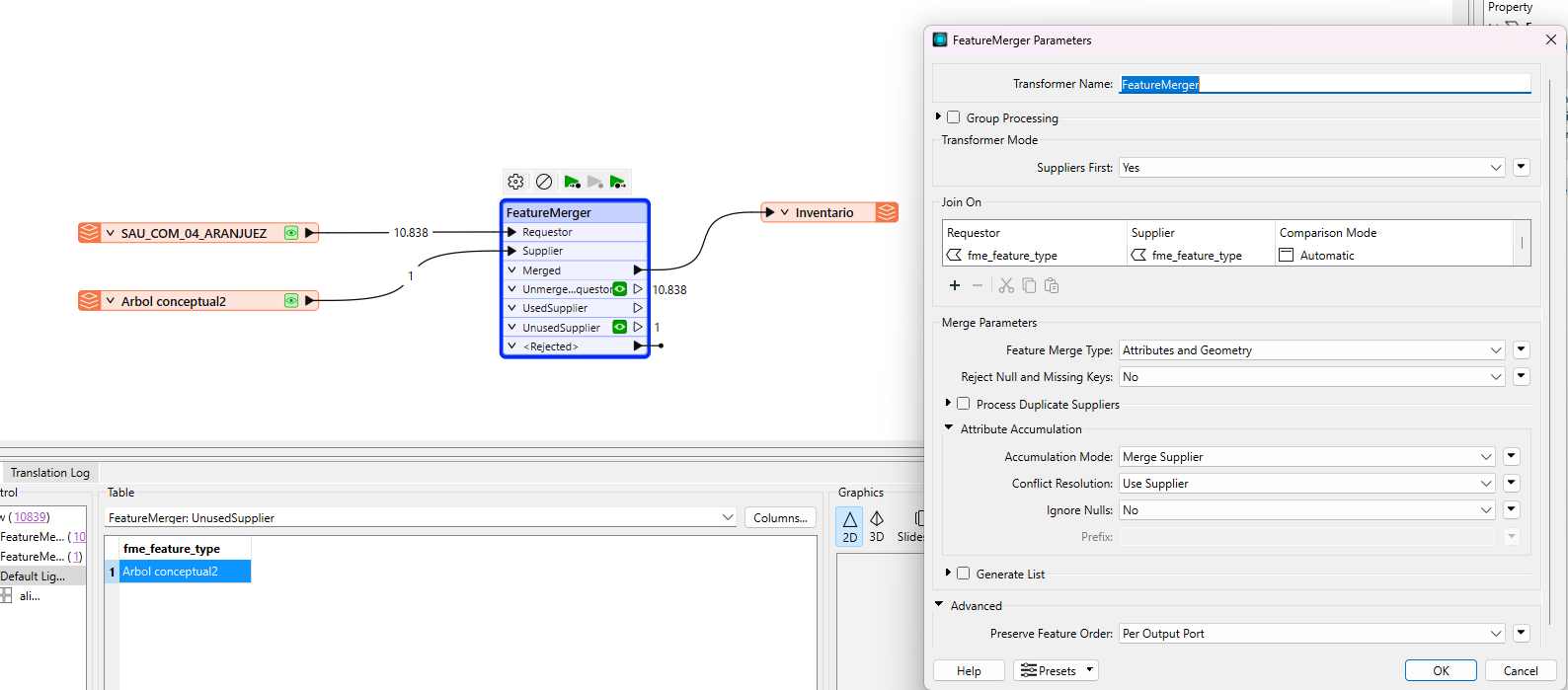

Thanks for your answer, but I'm still a bit lost, I have the following flow created, as I understand I must integrate both data in a “FeatureMerger”, when configuring the parameters how should I place them?
raghavendrans
Forum|alt.badge.img+28
I can pass the information on to you, if necessary
The Join On would be simply something like this:

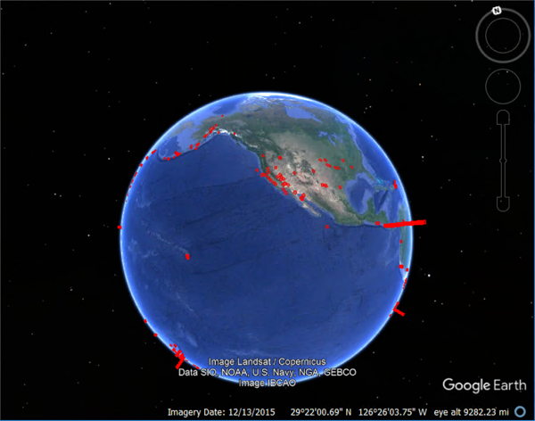

​The support for Collada dae files is limited in KML format to my knowledge. The Collada file that you may have for the 3D symbol for the points in SHAPE file may be a complex one with mesh geometry.
Though the dae file may be read by Collada Reader in FME, FME may have issues writing that to a KMZ file. So, I a rework could be to create 3D cylinders for the point locations using a KMLDiagrammer transformer.
The output KML would look something like this.
I hope this helps for now.
