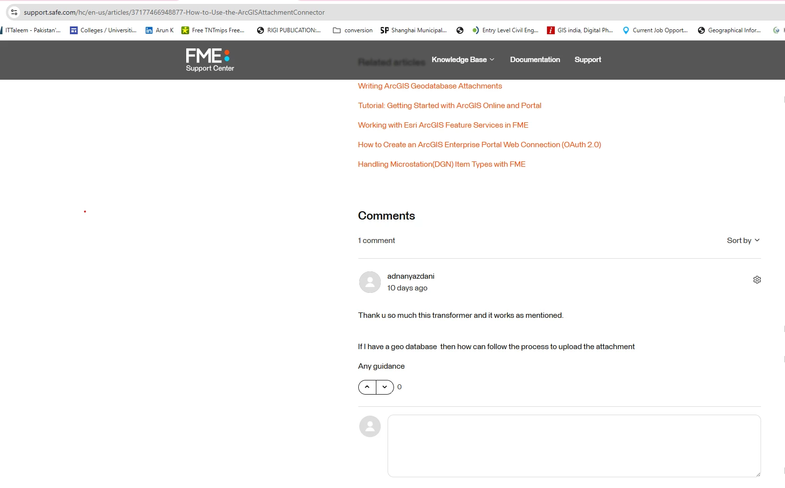

Thanks for the response and I have already implemented with this approach from service to local machine download for attachment and then uploading back to new feature service file..
My Query is
From Feature service(ArcGIS Onlineconnector and ArcGIS Attachment connector) to Designed new master GDB with attachments to be stored.
Any Approach on this

My comment on the article , I have asked last 10days before.
Thanks​​​​​​​

I did not see your comment on that article, besides you used another profile name. I responded to your question on this post. If your destination is to a geodatabase then there’s a well written document and video that’s been available for a while.
https://support.safe.com/hc/en-us/articles/25407508005645-Writing-ArcGIS-Geodatabase-Attachments
