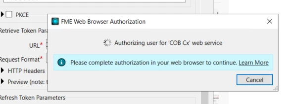

I’m trying to setup a web connection to Oracle Integration Cloud and have been given the client ID, secret, token url and scope url.
In testing the connection I keep getting this message but tje Integration Engineer is telling me there is no need to sign-in, and also no browser window is popping up for a sign-in.
Other posts had suggestions such as:
  • Change to System default instead of FME default
  • Change to proxy redirect instead of loopback.
I’ve tried those things and still nothing. Any tips on how can I troubleshoot this to get it to work?

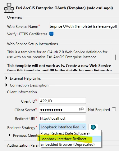

I know in FME2026 that external browser launching is no longer supported (by default)
External Browser Authentication in FME Form – FME Support Center
In Form > Web connections > Manage services… you need to alter the service to use
Loopback interface redirect method is now the oauth 2.0 preference
Also be sure to add http://localhost to the registered app > redirect URI settings
