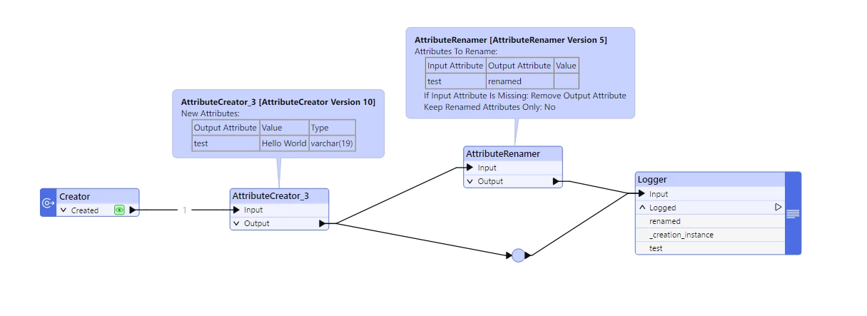

I can however, see it as being problematic in a couple of ways:
  1. I don’t always want it to change downstream references to it. I may want to change all, none or some. Regardless, it would need to have a user confirmation
  2. There will be a lot of trust in it working correctly, instances of the attribute used in lists, python, sql, json, xml, xquery, using @value(<attr>)
  3. What happens in instances where you have two branches merging into one, with the same attribute on both branches. If you rename on only one of the branches, what happens downstream where one branch isn’t renamed?
None of those are impossible to solve, but worth considering!

I like that idea, similar to how a parameter ID is updated on the canvas across all instances of it.
For me I would say that when saving a change in FME whatever code gets run to identify transformers pointing to broken or missing references should do some magic to try to identify whats changed. Perhaps you can right click on a transformer and select “update references”. Similar to updating transformers. You could select multiple at once or maybe there is a way to do all transformers at once.
In this case scenario 3 for me I would assume it would break/prevent any downstream changes because the transformers would still be valid. A feature like this might actually prevent such bad behaviour :-D.
Definitely trust will be an issue. But my god do I want something like this.
