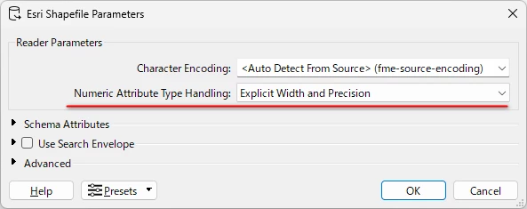

Hi ​@jdh , have you tried setting “Explicit Width and Precision” to the Numeric Attribute Type Handling parameter in Esri Shapefile reader?
