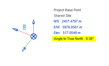

But some minor hurdles (from 2020.0):
  • I don't see a way how to read the "angle to true north" for survey and origin points:

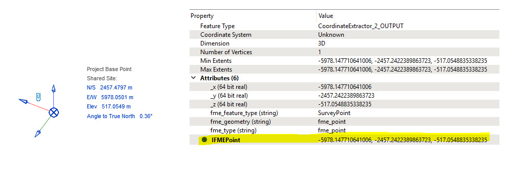

  • FME's "SurveyPoint" feature is a bit confusing: In most of my cases, FME's "SurveyPoint" is actually Revit's "Origin Point", just multiplied with -1?
