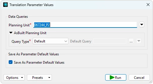

Here’s what my interface looks like with Query Type set to “Default”:

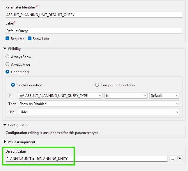

Even though the default value is set like this:

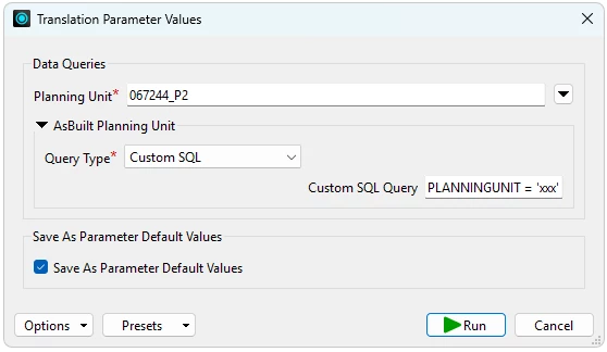

If I choose “Custom SQL” as my Query Type option then everything works as expected and the value comes through -- even the default value comes through correctly because the parameter is now hidden instead of disabled.

Just to add to this… it would be nice if a disabled parameter could also still show it’s value in the GUI rather than showing it as empty.
