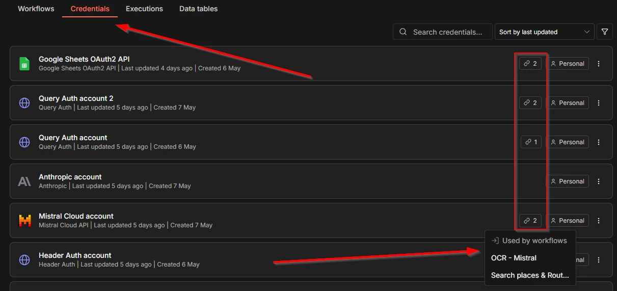

Something inspired by this (here in n8n) might be useful:
If we want to take the concept a bit further, it would be useful to have an interface or tool that exposes all dependencies between key components (for example, where workspaces are used, in which automations, schedules, projects, apps, etc.). The same would apply to web or database connections, as well as other major components.
With something like this in place, I think many users would consult this information before pushing major changes to production :)
