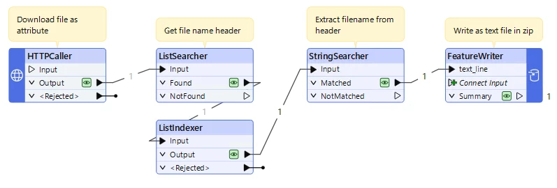

If you download the CSV as theΒ attribute β€˜text_file_data’, you can use a FeatureWriter with the Text File writer to write directly to a zip file:
I have attached a workspace to illustrate the process.
