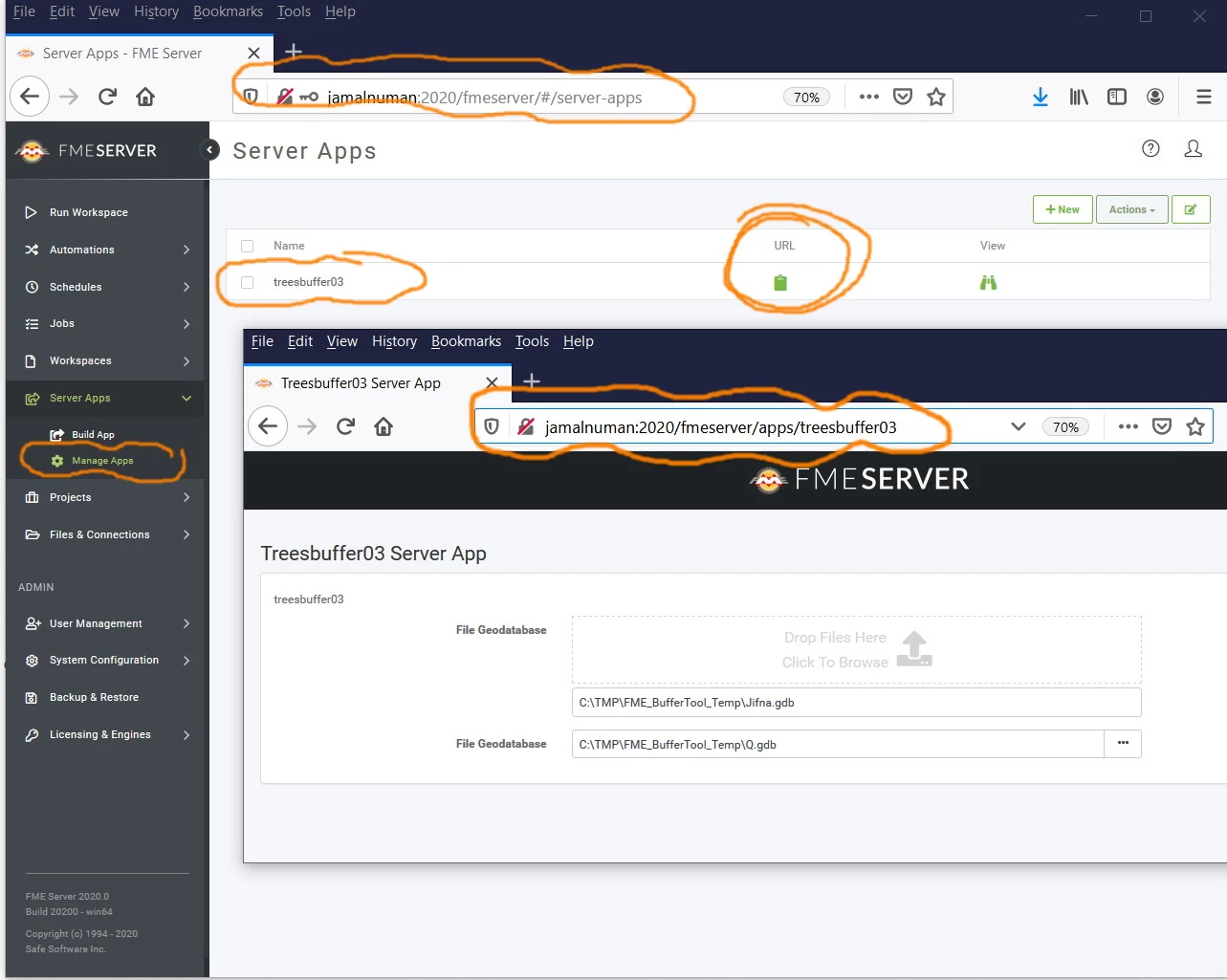

FME Server 2020.0: Accessing published services (App) without credentials,
It would be great if the published services (App) by FME Server can be accessed without the need to login. This is already implemented for the services published by ArcGIS Servers. These services can be approached without the need to login unless otherwise configured. The link below, for example, displays services that can be approached without the need to login
https://adaptor.geomolg.ps/adaptor/rest/services
what we are looing for is to have all the published App by FME Server displayed though the link:
http://jamalnuman:2020/fmeserver/apps/
