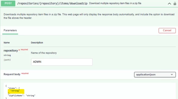

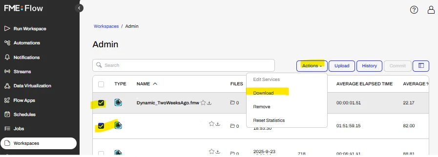

This exists if you go to the Workspaces, go into the Repository of interest and select the workspaces, some or all…. then action > Download
Actions > Download
It uses the v4 endpoint $(FME_SERVER_WEB_URL)/fmeapiv4/docs/index.html#/repositories/downloadRepositoryItemsZip
Downloading to zip requires items selected

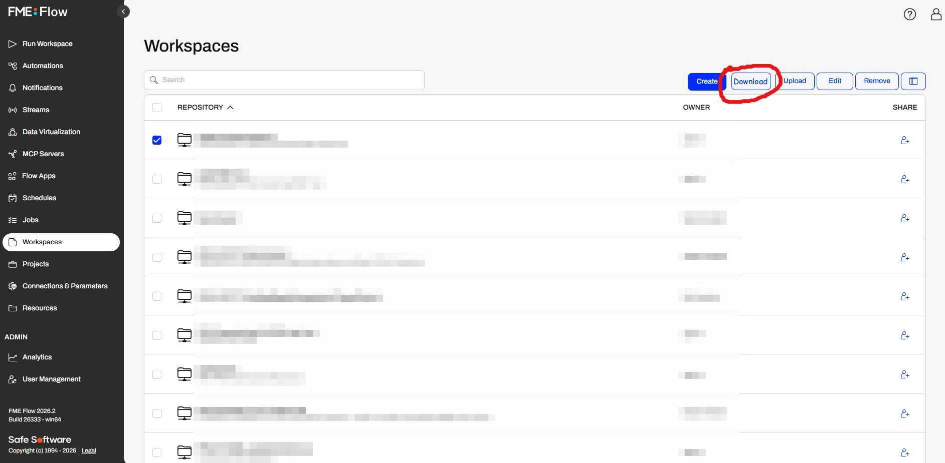

Hiya,
Yeah I get that it is there, I would like to see it here:

Within the repo you already have a bulk download, 2 clicks (select all) > download.

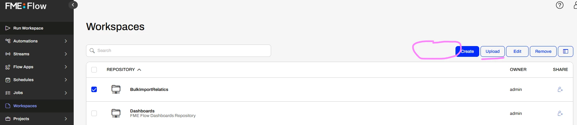

on the main repo page it would be more usefull (that's what you want):
mgg_beca
Forum|alt.badge.img+20
  • Sep 13, 2026 9:11 PM UTC
yes, this.
