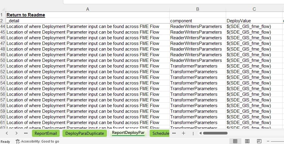

Yes, you can do it but it is not simple at all because you need to look across the entire environment and workspaces. But I do have it, in a rather large audit process (over 100 audits and reports) that we have been building for FME Flow. Just have a couple of organisations beta testing currently. I could potentially give access for a limited time, as I still need it tested in a few more varied environments. And no, we don’t see or get any of the information, so I would have some expectations around users providing feedback.

The new dependencies REST endpoint delivers for every automation/schedule/workspace the dependencies including deploymentParameter. So it is possible to get every reference to a parameter by using the fmeapiv4 but currently only the other way around, list everything to get every occurence of the parameter of interest.
To allow a type deploymentParameter as input would be nice.
