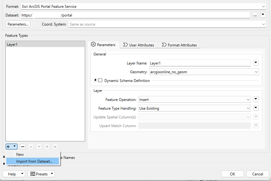

Just looked at the featurewriter, and found that same “Import from Dataset” option here:
But then you have to go through the whole portal sign in process again:
I feel like this process could be streamlined, both for the regular writer and the FeatureWriter transformer.
  • May 13, 2025
Import from Dataset on the writer picks up the portal connection details from the writer for me. I'll see if it's different the feature writer
