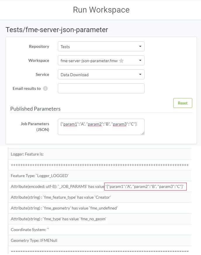

I noticed that FME removes every double quotation from a parameter value formatted in JSON if it was passed via the JavaScript API FMEServer.runDataDownload function.
This is a simplified workspace: fme-server-json-parameter.fmw (FME 2017.1.2.1)
If you run it from the FME Server Web UI, the JSON parameter will be preserved correctly. Good.
However, if you run the workspace from an external web application with the API function, FME will removes every double quotation from the JSON parameter, and therefore it cannot be parsed as a valid JSON document. e.g.

Hi @takashi,
I took a look at your workspace and the parameter you are passing the JSON object to is a Text (Multiline) type parameter. To pass the JSON object correctly to the Data Download service the quotes of the JSON object need to be escaped before they are sent in the post request. Here is an example how you could do this in your script:
var parameters = ('JOB_PARAMS=' + JSON.stringify(jsonParams)).replace(/"/g,'\\\\"');
The JSON Object will be posted like this:
{\\"param1\\":\\"A\\",\\"param2\\":\\"B\\",\\"param3\\":\\"C\\"}
This should give you the result that you expected.
When you submit the job via the FME Server Web UI this is already handled by FME Server.
I hope this helps!
