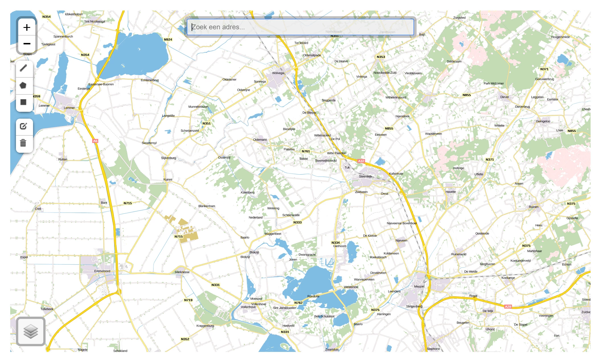

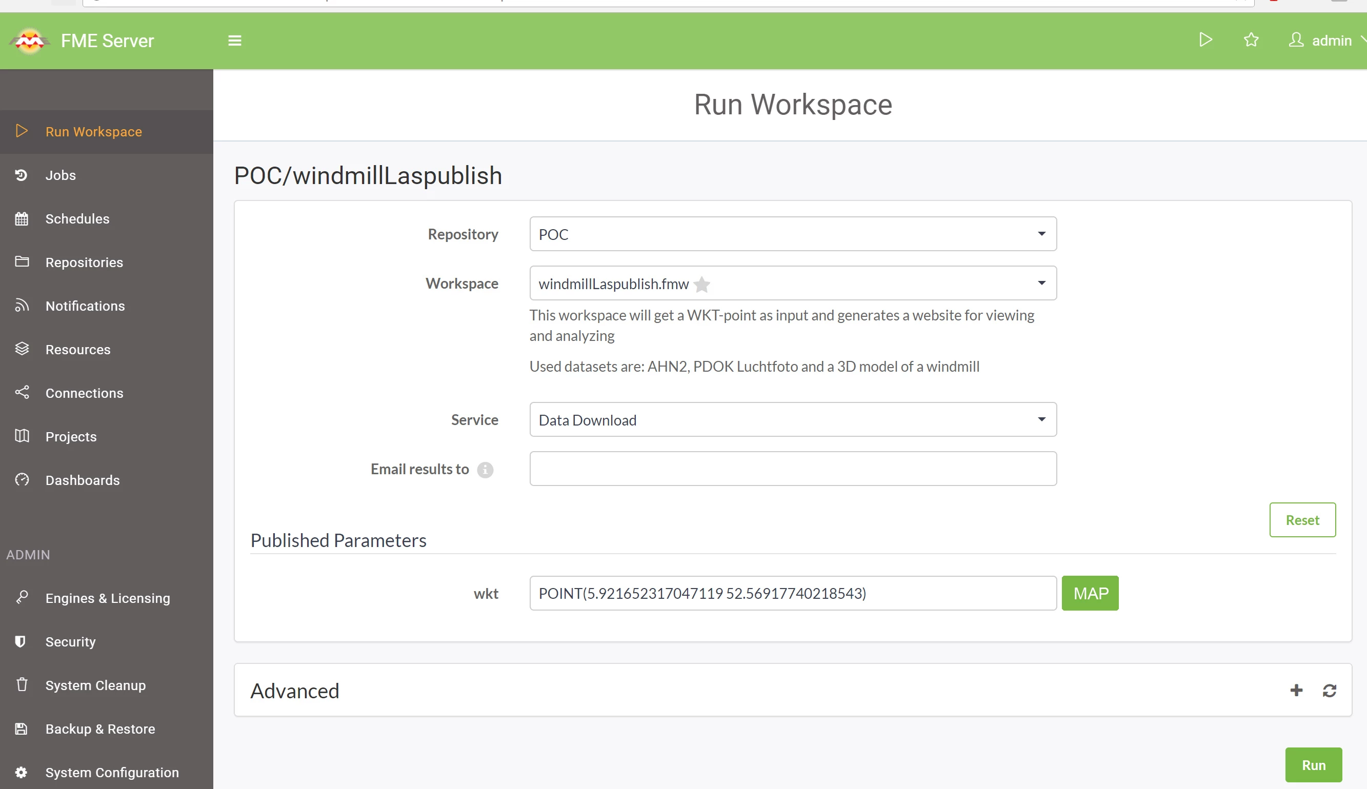

If you need a polygon,line or a point as input for a workspace then it would be nice if the user interface provides a map component to draw the object so you can use it.
For now I use a custom form with some javascript: Wicket
But it would be nice to have it implemented into the standard web interface of FME server.
