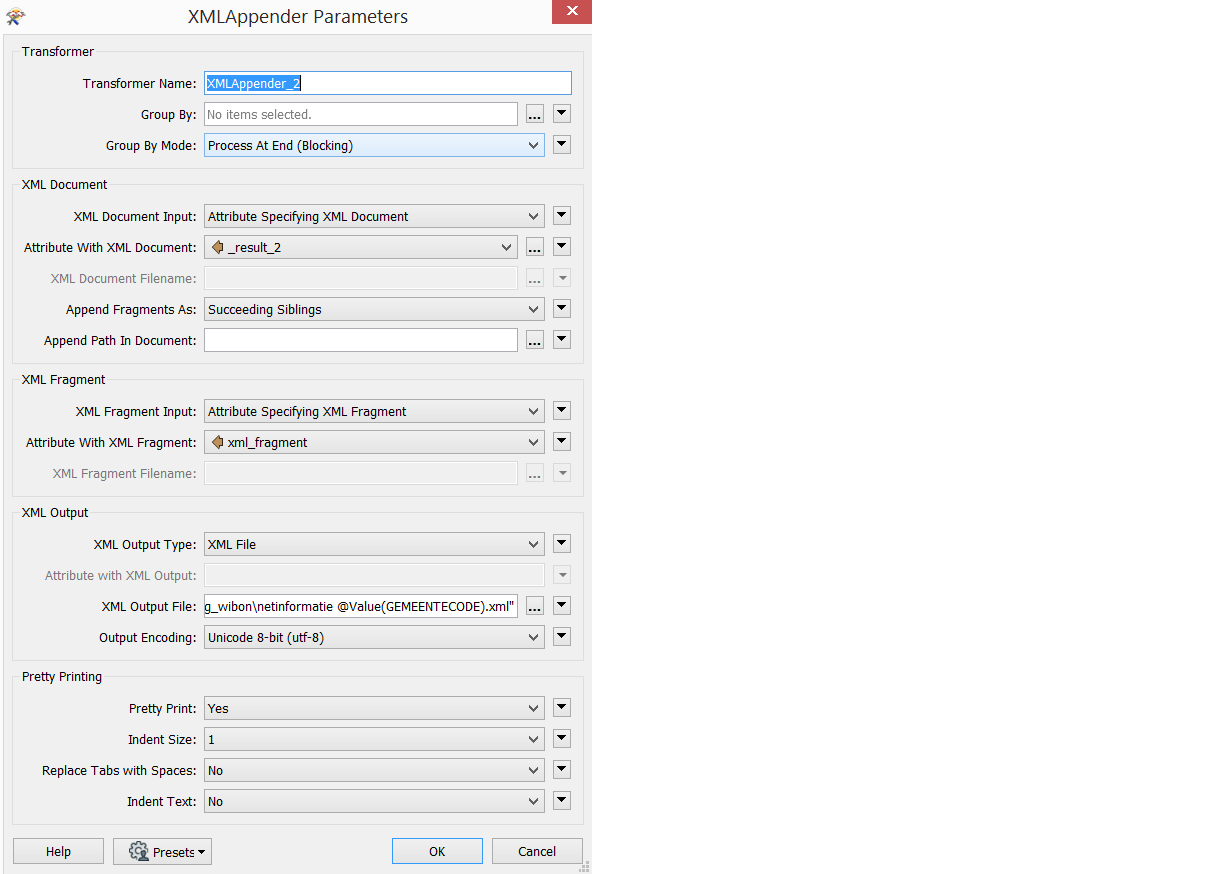

When running a workspace with an xmlfragmenter and xmlappender on with fmedesktop everything is going fine. But publishing it to fme server en running it there I get the following error. element name expected

Bringing the fragments together with the xmlappener running on fme server 2020.1.3 gives an error:
193 2020-12-11 16:35:05 | element name expected
194 2020-12-11 16:35:05 | An error occurred while appending an XML document: 'element name expected'. The parsing fragment is identified by: 'xml_fragment'
