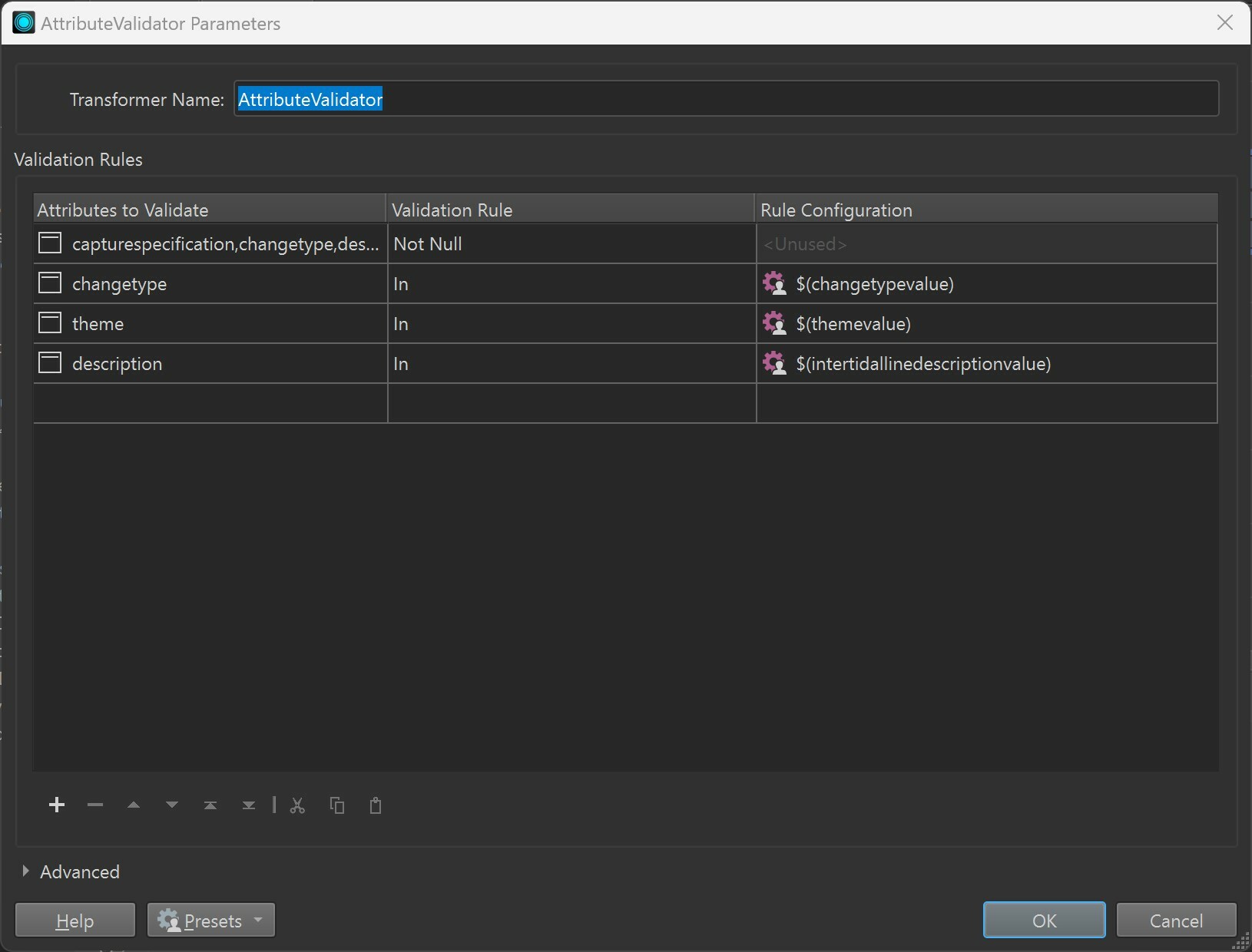

@mattmatsafe​ that is perfect, absolutely what I was after, just the smallest request, could the icon stay green and not change back to pink in desktop to save confusion and differentiate the parameter types

For the most part, the icon should remain green, however, I do see that if a deployment parameter is used as a Rule Configuration value in an Attribute Validator, or in other cases where the control is an inline drop-down list, it does not. I have created an internal ticket for that to be addressed in a future version (ID FMEFORM-29466).
