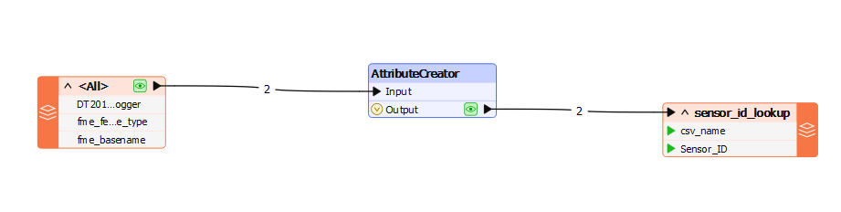

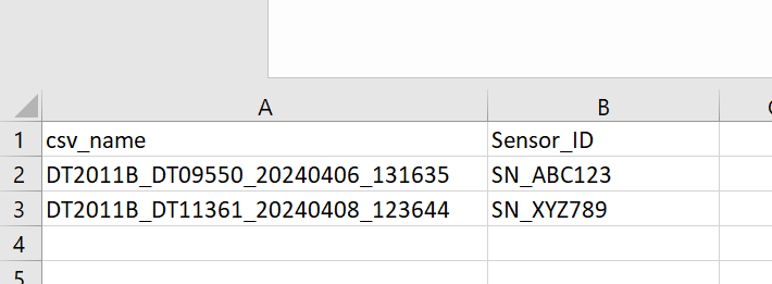

Step 1: Create a lookup csv file containing two columns, first column is the name of the csv file that you are processing and the second column for the Sensor_ID.
For the CSV file name, the fme_basename format attribute needs to be exposed on the Reader Featuretype.
For this step, the workspace will read all the CSV files of interest and create a sensor_id_lookup CSV file.
The output CSV would be something like this:
The CSV Reader would read only the first two lines.

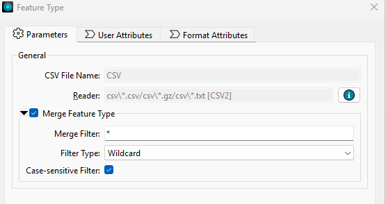

This step involves a CSV to CSV workspace reading from row 27 (header) and 28 (data) with the a Reader FeatureType set to Merge Featuretype

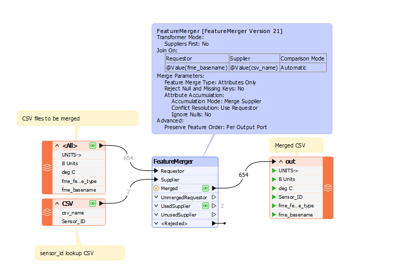

Again, for the featuremerger down the line, the fme_basename format attribute needs to be exposed on the Reader Featuretype.
You will add another CSV Reader for the Sensor_ID lookup.
Then use FeatureMerger to merge based on the fme_basename for the CSV files featuretypes and the csv_name value from the Sensor_ID lookup csv.
The workspace would look like this:

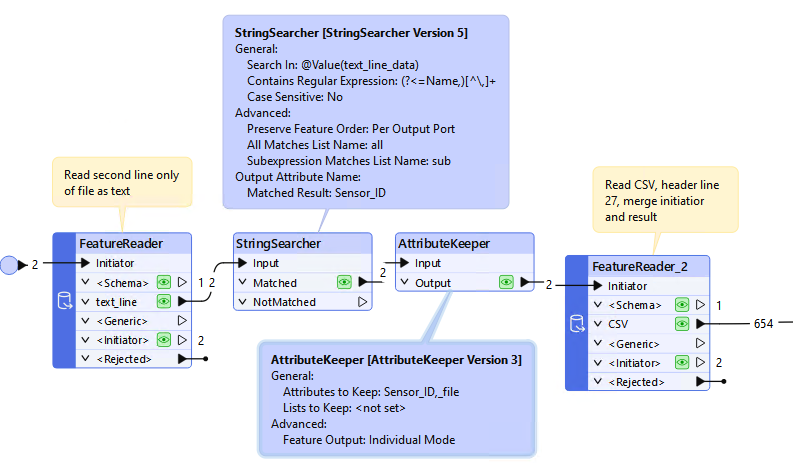

I would use this sort of workflow, rather than merging
You can use a text file reader to read just the second line and extract the Sensor_ID, keep that attribute and the filepath and send to a second feature reader to read the CSV file from 27 onwards, if you merge initiator and result the Sensor_ID relating to the file will be added to all features.
