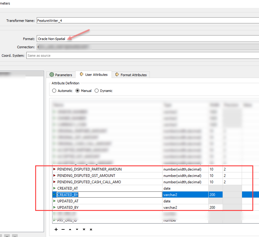

So we updated to Oracle 12 and it allow as to create column more than 30 characters. Wonder how we can allow this feature in FME Oracle FeatureWriter
Currently I can't find way to enter columns that will have more than 30 characters. See attached picture for details.
FME(R) 2018.1.1.1 (20181203 - Build 18578 - WIN32)
Any Ideas?

Hi @ukrsolid​, I see that in FME 2018, the attribute is automatically truncated to 30 characters. It's seems have been addressed in later versions of FME. I tested it in the latest FME Release 2020.1 and the FeatureWriter allow for attributes greater than 30 characters:

Thanks,
will install 2020 for test.
