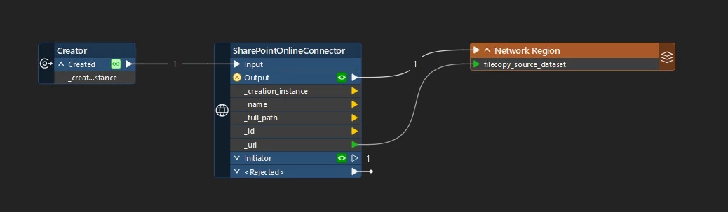

Any update on this? I was able to get all the permissions and whatnot. I just need to download the file in each subfolders. I can see the filesΒ
And this is what my workspace looks like but nothing seems to be happeningΒ
The destination folder remains empty. I’ve tried all output ports

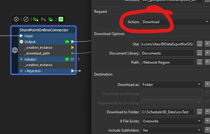

Neverminsd. I got it. Note to self : Get a cup of coffee first thing in the morning 😁I had the wrong settings. should be download instead of List
