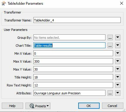

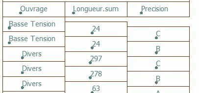

Hi!
I'm using TableAdder to create a table for a pdf writer. I'm having problem to align the rows. Can someone help me please.
Thanks.

You need to go into the TableAdder custom transformer by right clicking and choosing Edit
Then find the TextBoxAdder_3
in the Min Y value box of this transformer copy and paste
$(MAXYVALATTR)-$(HEIGHT)*2-2*$(HEIGHT_2)*@floor((@Value(_count)/(@Value(AttributeCount))+2))
In the Max X value box copy and paste
$(MAXYVALATTR)-$(HEIGHT)*2-2*$(HEIGHT_2)*@floor((@Value(_count)/@Value(AttributeCount)+1))

Thank you very much, it works ! :)
