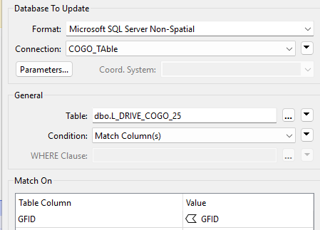

gisbradokla
Forum|alt.badge.img+27
I have always tried to use the databaseupdater but have always had issues with it.
Why if i have a unique column with GFID values and i want to match that it gives the error.
Microsoft SQL Server Non-Spatial Writer: Failed to write a feature of type `dbo.COGO_23' to the database. Provider error `(-2147217900) The data types text and text are incompatible in the equal to operator.'. SQL Command `UPDATE [dbo].[COGO_23] SET [GFID]=?, BLAHBLAHBLAHWHERE [GFID]=?'
this is a flat mssql table with no geometry.

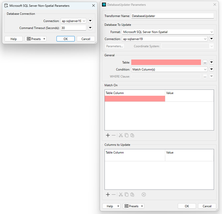

Hello, ​@gisbradokla.
Sorry you’re still running into issues with this error. Would you be able to try increasing the Command Timeout parameter and see if that helps out? Image for reference:

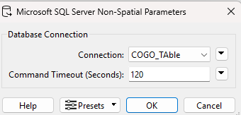

I can try that.
It seems as far as the log shows that it is attempting for hours instead of the 30 seconds specified in the parameter setting.
3154    2025-4-24 20:39:36 | Reading source feature # 2000
3155    2025-4-24 20:40:06 | Microsoft SQL Server Non-Spatial Writer: Failed to write a feature of type `dbo.L_DRIVE_COGO_25' to the database. Provider error `(-2147217871) Query timeout expired'. SQL Command `UPDATE [dbo].[L_DRIVE_COGO_25] SET [GFID]=?, [process_flag]=? WHERE [GFID]=?'
3156    2025-4-25 00:32:52 | ... Last line repeated 449 times ...
3157    2025-4-25 00:32:52 | Reading source feature # 2500
3158    2025-4-25 00:33:22 | Microsoft SQL Server Non-Spatial Writer: Failed to write a feature of type `dbo.L_DRIVE_COGO_25' to the database. Provider error `(-2147217871) Query timeout expired'. SQL Command `UPDATE [dbo].[L_DRIVE_COGO_25] SET [GFID]=?, [process_flag]=? WHERE [GFID]=?'
3159    2025-4-25 04:50:53 | ... Last line repeated 499 times ...
3160    2025-4-25 04:50:53 | Reading source feature # 3000
3161    2025-4-25 04:51:23 | Microsoft SQL Server Non-Spatial Writer: Failed to write a feature of type `dbo.L_DRIVE_COGO_25' to the database. Provider error `(-2147217871) Query timeout expired
parameter changed to 3x
