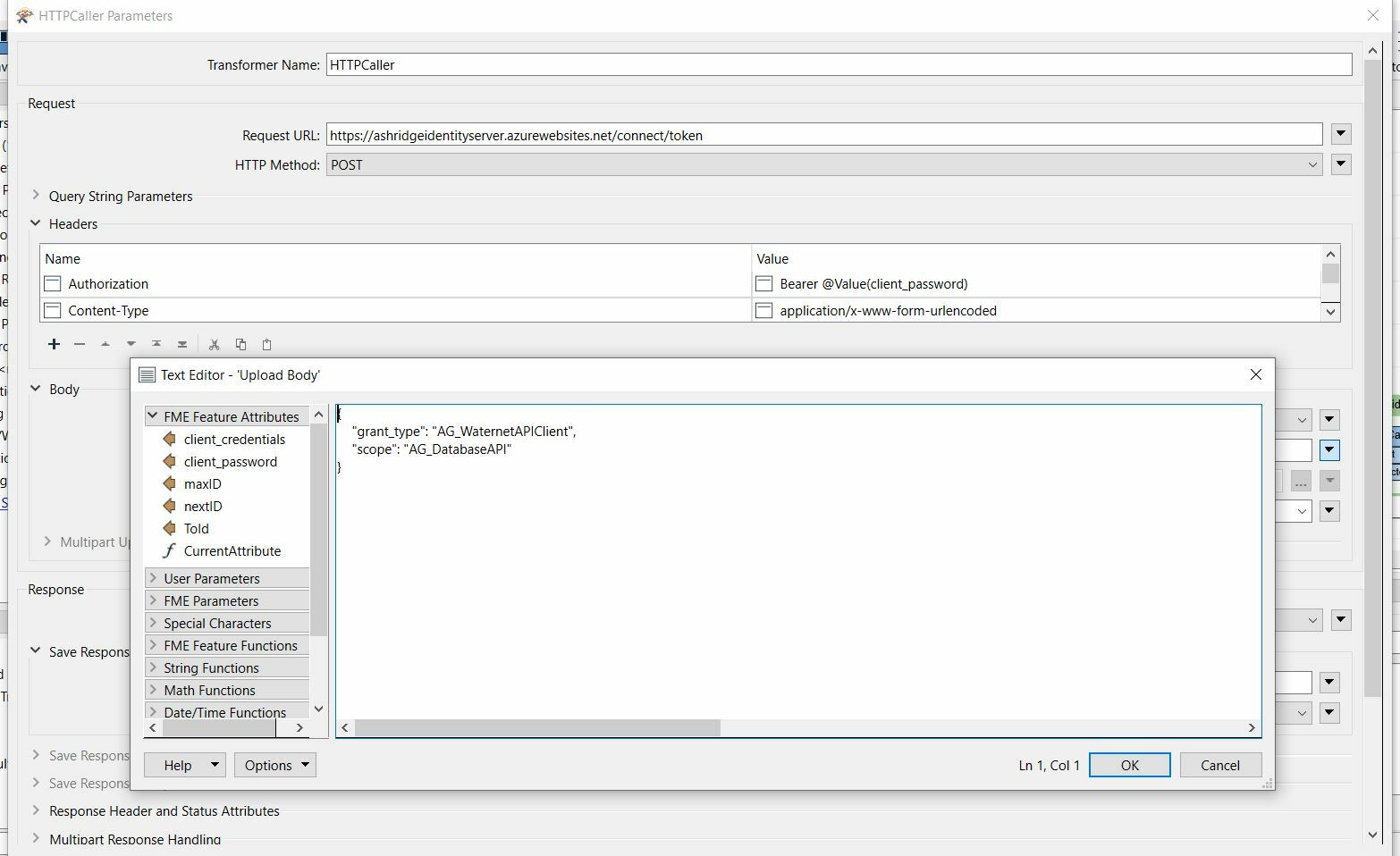

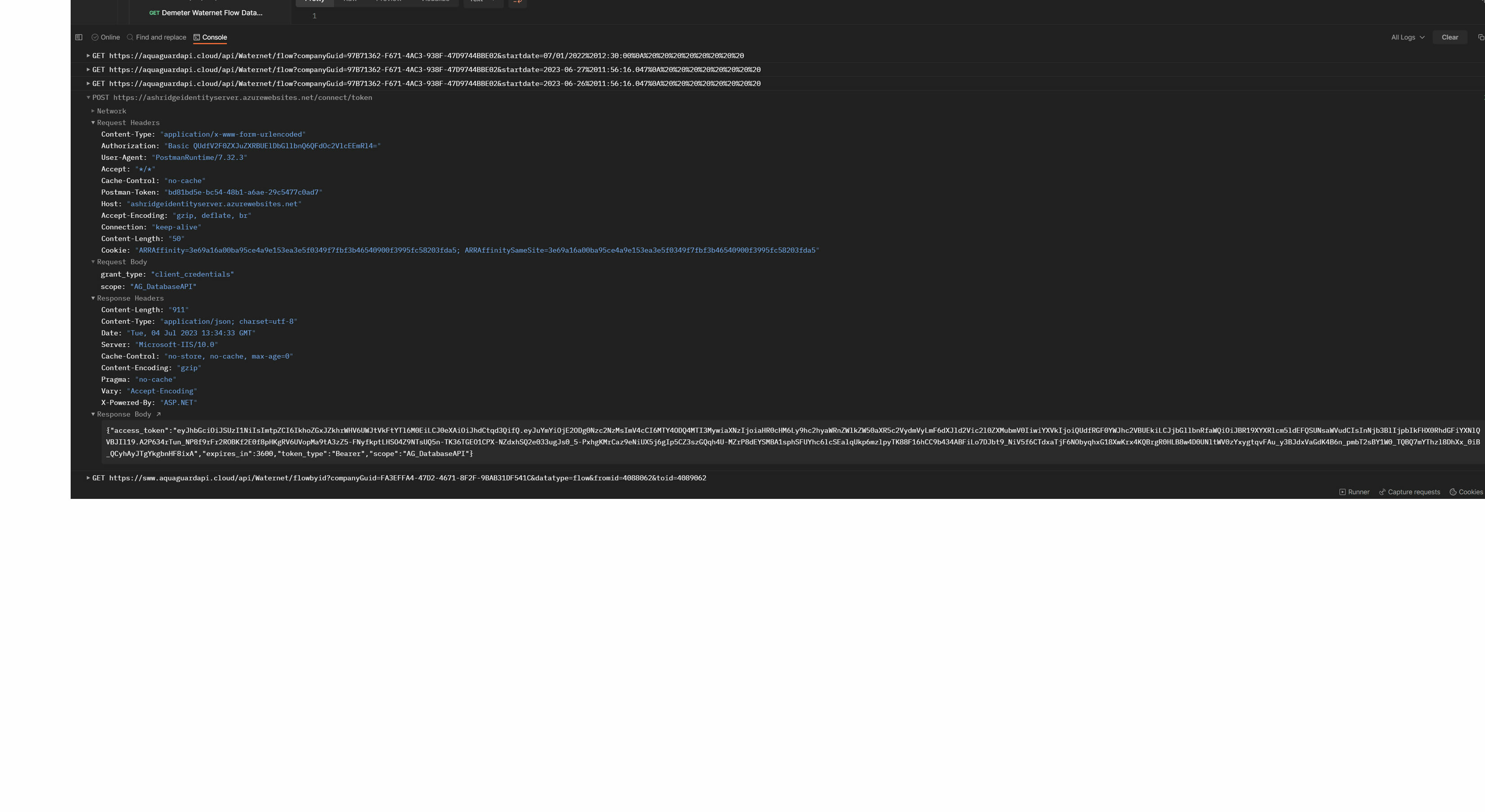

Our supplier has changed their API and are now using OAuth. I'm struggling to connect, mostly because they are very unhelpful about what is needed in the Header and Body to access the credentials API
I have been given this information:
access token URL https://ashridgeidentityserver.azurewebsites.net/connect/token
OAuth 2 with Client Credentials
Client ID : AG_WaternetAPIClient
Client Secret : **********
Client Scope : AG_DatabaseAPI
And a screenshot from their POSTMAN service.
Can anyone help me set up the HTTP Caller? I have added the client secret to a Bearer Token thus far but just get "bad request"

Ok things that I can see in the screen shot which should help:
  1. The POST content type here is not JSON but form-urlencoded (you can use the Multipart / Form Data Upload Data in FME
  2. From the screen shot the "client_type" in the post should be "client_credentials"
  3. Authorization header looks to be "Basic" which means you should just need to provide your username and password in the HTTPCaller using the Basic authentication method (and no need to set the Authorization header).
So you should be able to use just your client id and secret here as username and password to generate the token. It's the token which you get back in the response (access_token).
imageUsing these settings gave me a {"error":"invalid_client"} response. So seems to work

Morning Matt,
Thanks very much - that's a great help. I've added the details but now get the error message "{"error":"unsupported_grant_type"}". Any ideas on that one?

Morning Matt,
Oh, interesting - You could try putting the string in quote marks but I assume that FME will handle that but maybe not.
The other thing to try is to submit the post like this:
This might be the more appropriate method. Here we are specifically using the same content type here. This might have been the problem. The Upload body here I've just put it in as if it were at the end of the URL. (https://stackoverflow.com/questions/4007969/application-x-www-form-urlencoded-or-multipart-form-data)

Hi Matt,
Finally got this to work after a bit of tinkering:
imageLooks like the grant_type and scope have to be in the right order, and the user credentials not added to the Body as part of the string.
