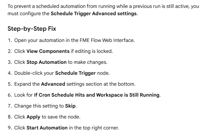

Is this an AI hallucination or something new in 2026, I suspect the former but the latter would be nice...

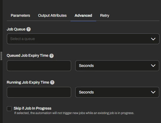

the setting was there since 2024 (I am in 2024.2), or even earlier. It’s not scheduler trigger, it’s under Action (running workspace).

That’s on the workspace not on the schedule trigger in an automation and it’s skip if job in progress. Subtly different from being able to skip if automation is in progress
