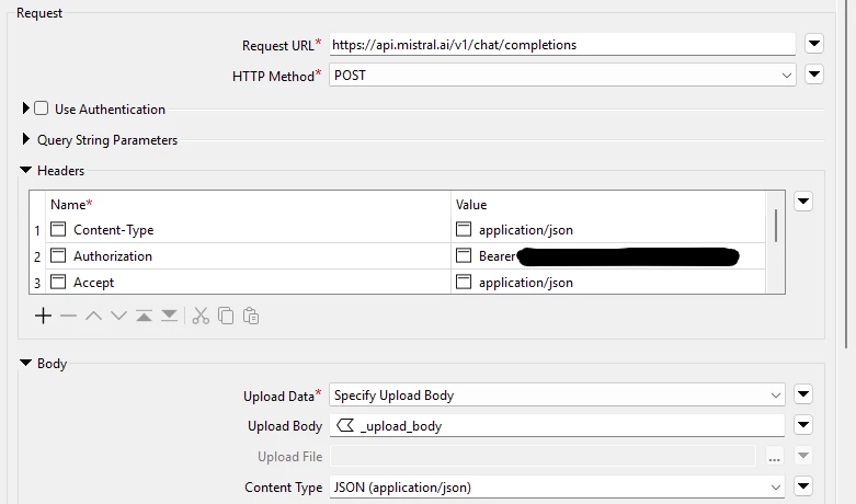

Wondering if anybody has successfully connected to Mistral using FME. I'm trying to work through a very basic sample, straight from their documentation, but no luck, I keep getting an error that seems to imply there's something wrong with my request body:

My HTTPCaller settings:
I have a feeling I'm missing something really obvious, but I'm at a loss to what that would be...

I hadn’t tried that, but I have now and it works, so to be honest I’m not going to bother troubleshooting my own efforts much more. I suspect it has something to do with hidden characters (tabs and spaces) in the messages part of the request. Apparently Postman cleans that up for you.

Nice ! IΒ made that some time ago. We have plans to rework intoΒ an FME Package.
"I suspect it has something to do with hidden characters (tabs and spaces) in the messages part of the request. Apparently Postman cleans that up for you."
Maybe a JSONFormatter set to Linearize could have done the trick there πŸ€”
