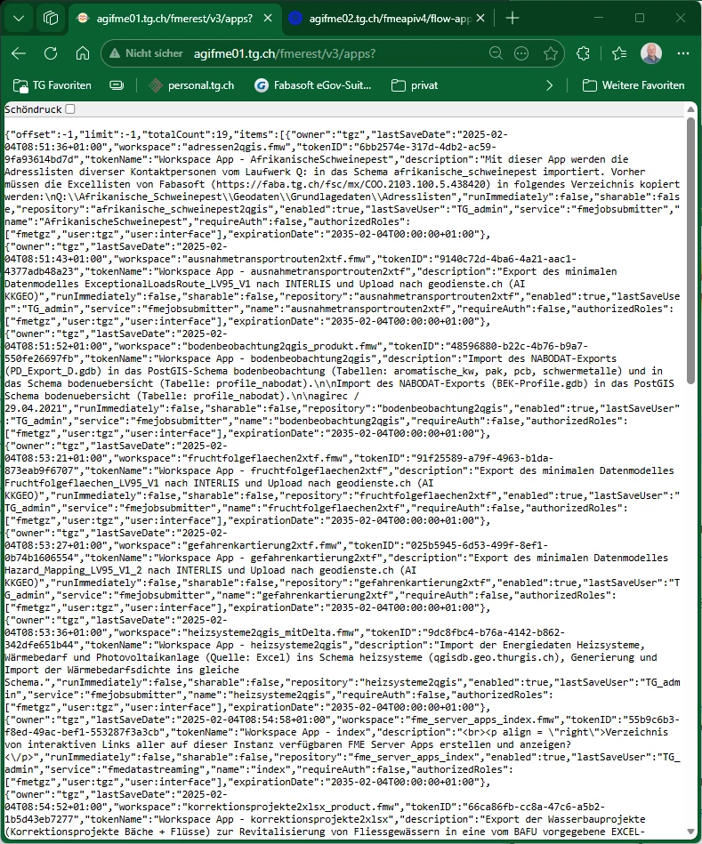

We need a FME Flow data stream which generates an HTML page showing an index of all available FME Flow Workspace Apps on our FME Flow instance.
In FME Server 2022 REST API V3 we used [FME_Server_instance]/fmerest/v3/apps?.

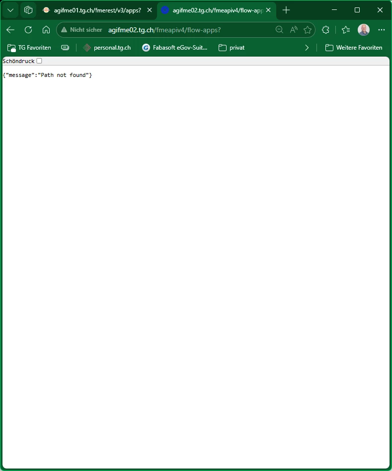

In FME Flow 2025 REST API V4, when we use the analogue [FME_Flow_instance]/fmeapiv4/flow-apps?, we do not obtain a result.
Which is the appropriate call to obtain the information on all Workspace Apps available on an FME Flow instance in REST API V4 (as e.g. is [FME_Flow_instance]/fmeapiv4/repositories? to obtain all Repositories)?

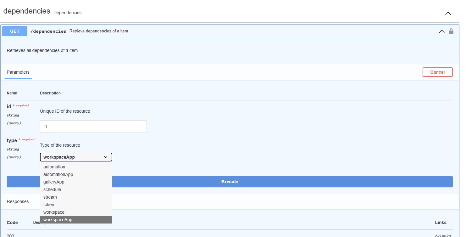

I had some luck recently using the /dependencies endpoint
 https://docs.safe.com/fme/html/fmeapiv4/docs/index.html
 /dependencies endpoint to locate where the  resource “Type” is workspace app
In workspace build out a few HTTPCallers and JSONFragmenters
some tips in this article https://support.safe.com/hc/en-us/articles/25407702974733-Using-the-FME-Flow-REST-API-V4-to-Create-Job-History-Reports

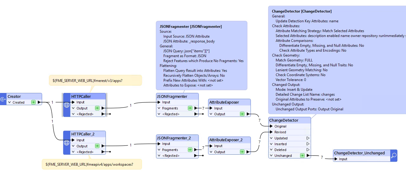

Congratulations, now you gave me the clue:
[FME_Flow_instance]/fmeapiv4/apps/workspaces? seems to be the solution!
However, for some reason this is not listed in the FME Flow REST API V4 documentation!
