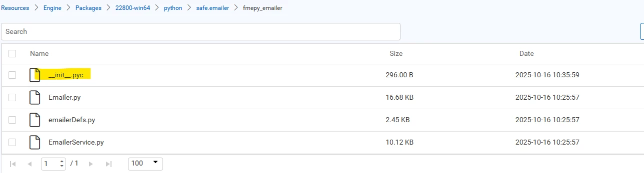

nasir
Forum|alt.badge.img+3
  • Oct 21, 2025 9:28 AM UTC
Hi Ji
Thank you for your answer. However, my issue gets resolved by uploading an init file on resources, for some reason when publish the flow on FME flow, that init file missed.
