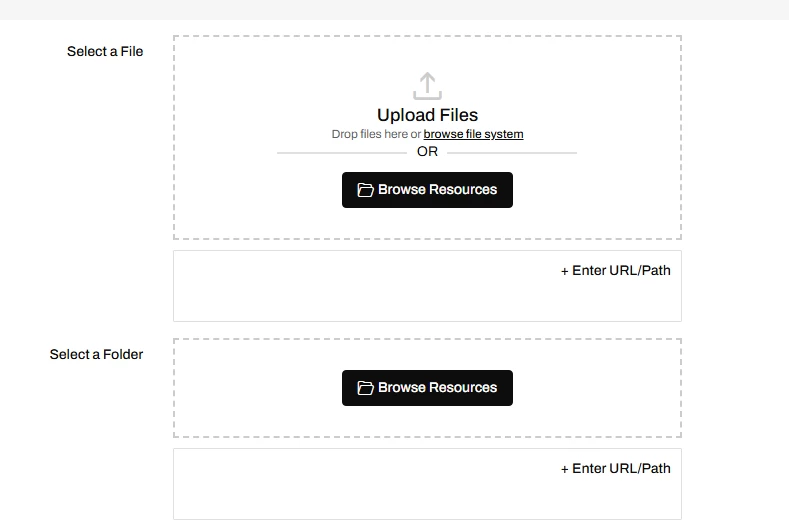

This is how my app looks like,
pic.1 .
then when i click on browse resources i get this page,
so i cant actually select any folder from my local computer.

From https://support.safe.com/hc/en-us/articles/25407748431501-FME-Flow-Troubleshooting-Flow-Apps:
Problem: “My app has a file/URL parameter that is visible, but users don’t have the option to upload files. They can only browse for resources on FME Flow.”
Solution: In your Flow App settings, ensure the setting ‘“User Can Upload” is enabled.
After that, the app should look something like this:
(but I'm not sure this wil work for a folder..)

It does look like if you have a folder parameter, you don’t get the option to browse the file system to select a folder. I’m not sure whether this is by design or not...
alexbiz
Forum|alt.badge.img+14
  • July 7, 2025
Most web browsers don’t support uploading a folder. You have to zip it if you want to send an entire folder.
