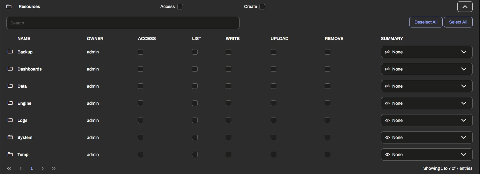

Hello everyone,
unfortunately i do have a “problem” with a workspace-app. The workspace-app has an upload-field where you can also click “Browse Resources”. Clicking on that opens a windows with two tabs (default as i understand it). One “Resources” and one “Temporary Uploads”.
The goal is to configure it in a way that the “Resources” tab is not available/visible.I checked out this question here Enabling "Resource" tab in workspace application. | Community. However, not granting any permissions in the “Resources” area of the API-token  for this app does not solve it.
Basically doing the opposite of the anser given in the linked question,
Are there any other configuration parameters i overlooked?

it might be worth mentioning that the app as permissions for:
  • the repository in which the workspace lives
  • Job submitter and data upload services
  • one web connection
FME Flow Version is 2025.1.2 but with 2025.1.0.1 the same behavior was observed

Can confirm - Just tested this in FME 2025.1 and the Resources Tab is there. No access to any resources but it’s not ideal.
This is not present in FME 2024.2 for some apps that I’d previously set up - so seems like you’ve done everything correct and the issue is more version specific.
Wouldn’t be too much of an issue, however, as the Resource tab is the first one the end user sees it’s not clear that the user is able to upload. Not the best user experience.
