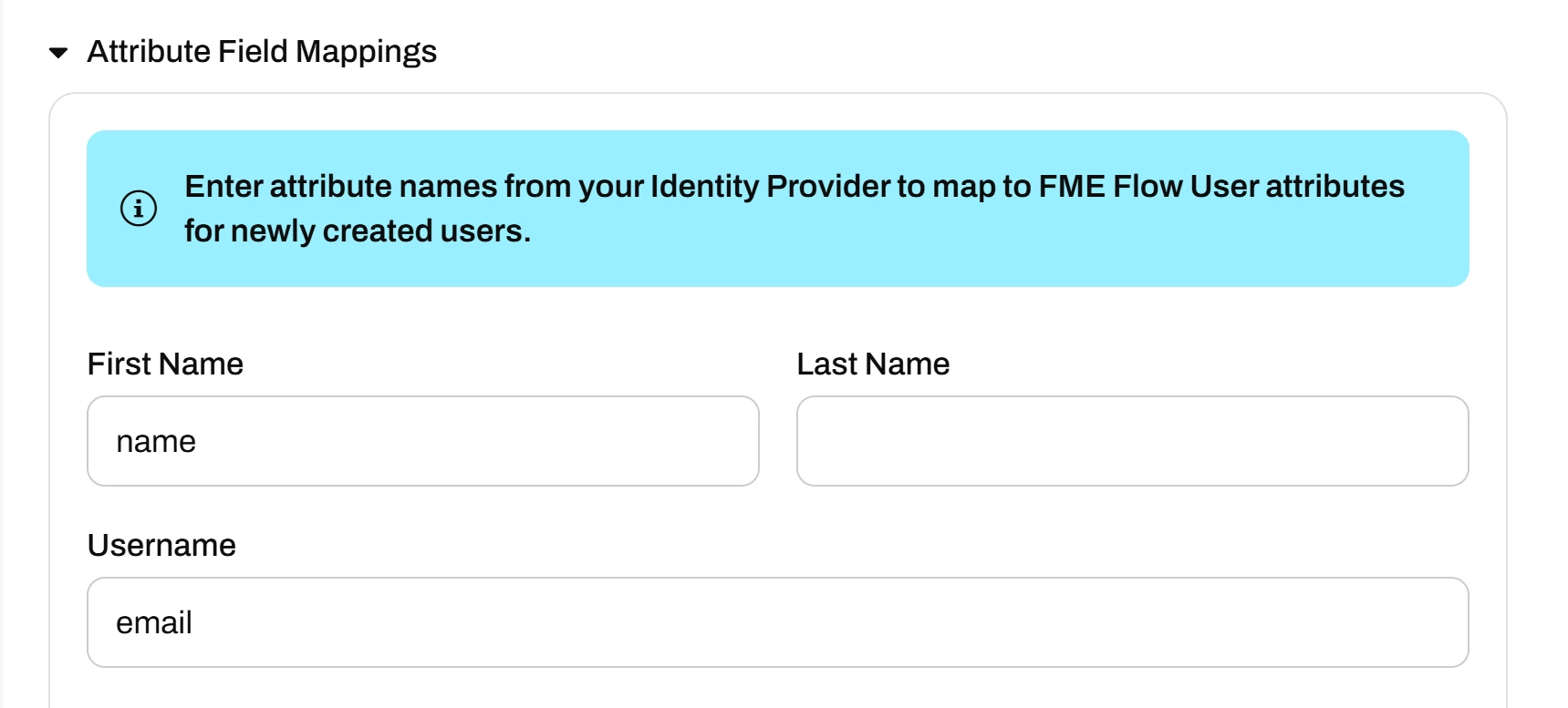

That’s correct - usernames have to be unique across all users, not just those from the same authenticated method. Because of this, we generally recommend setting the username field to “email”:
