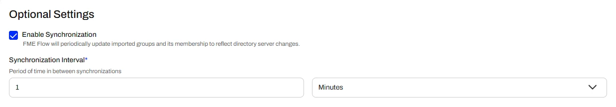

I have integrated Active Directory with FME Flow by linking the security group, but the usernames still do not appear under User Management > Users. Do I need to add the users manually, or should they be synced automatically from the AD group?

If you enable synchronisation under advanced settings, FME will periodically pole AD/Entra and pull through accounts added/removed to groups
Β
You need to firstly import these groups, but from there fme should pull through any changes to the group.
Β
If you’re not using groups, then you need to manually import each user
