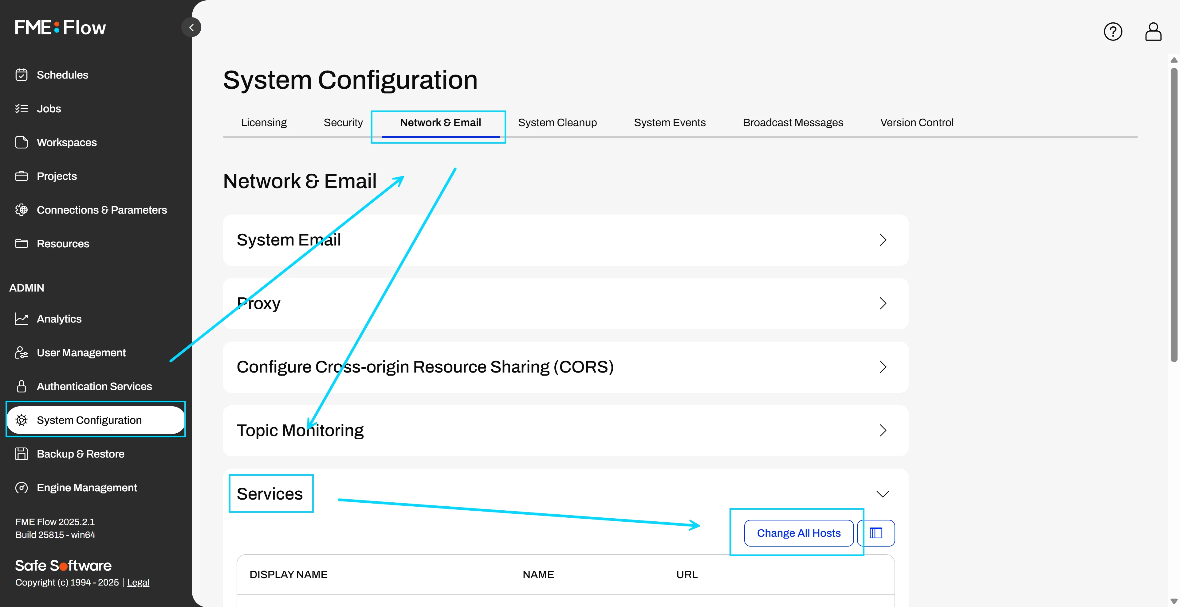

If not, I’d next if check the Service URLs have been updated after configuring HTTPS. Do this from System Configuration > Network & Email > Services:
In almost all instances, the hostname should match the hostname you use to access Flow. It should be HTTPS if you use HTTPS to access Flow also.
