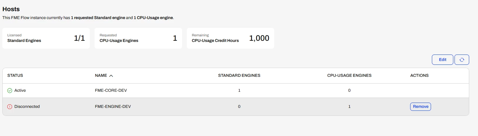

shraddha.patel
Forum|alt.badge.img+1
This is what is looks like now
shraddha.patel
Engine is registered with core but it is “Disconnected”
