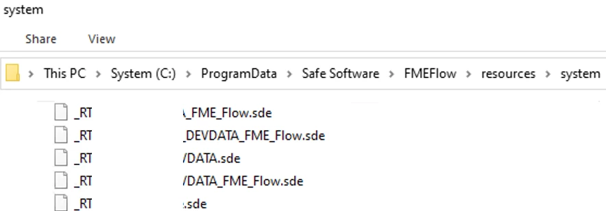

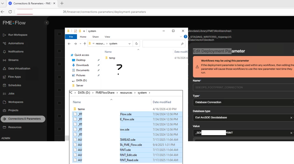

2026-4-21 16:25:07 | An error occurred while attempting to retrieve the connection parameters from the connection file 'D:/FMEFlowShare/resources/system//_RTIOSDE_TEST_DEVDATA_FME_Flow.sde'

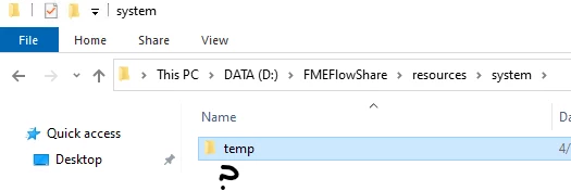

Deployment parameters, specially SDE file connections….are not restored from application backup, when you change the Flow Shared Resources from the C:\ProgramData\Safe Software
to a D:\FMEFlowShare

Resolved by manually restoring the .sde files to the System folder in shared resouces
