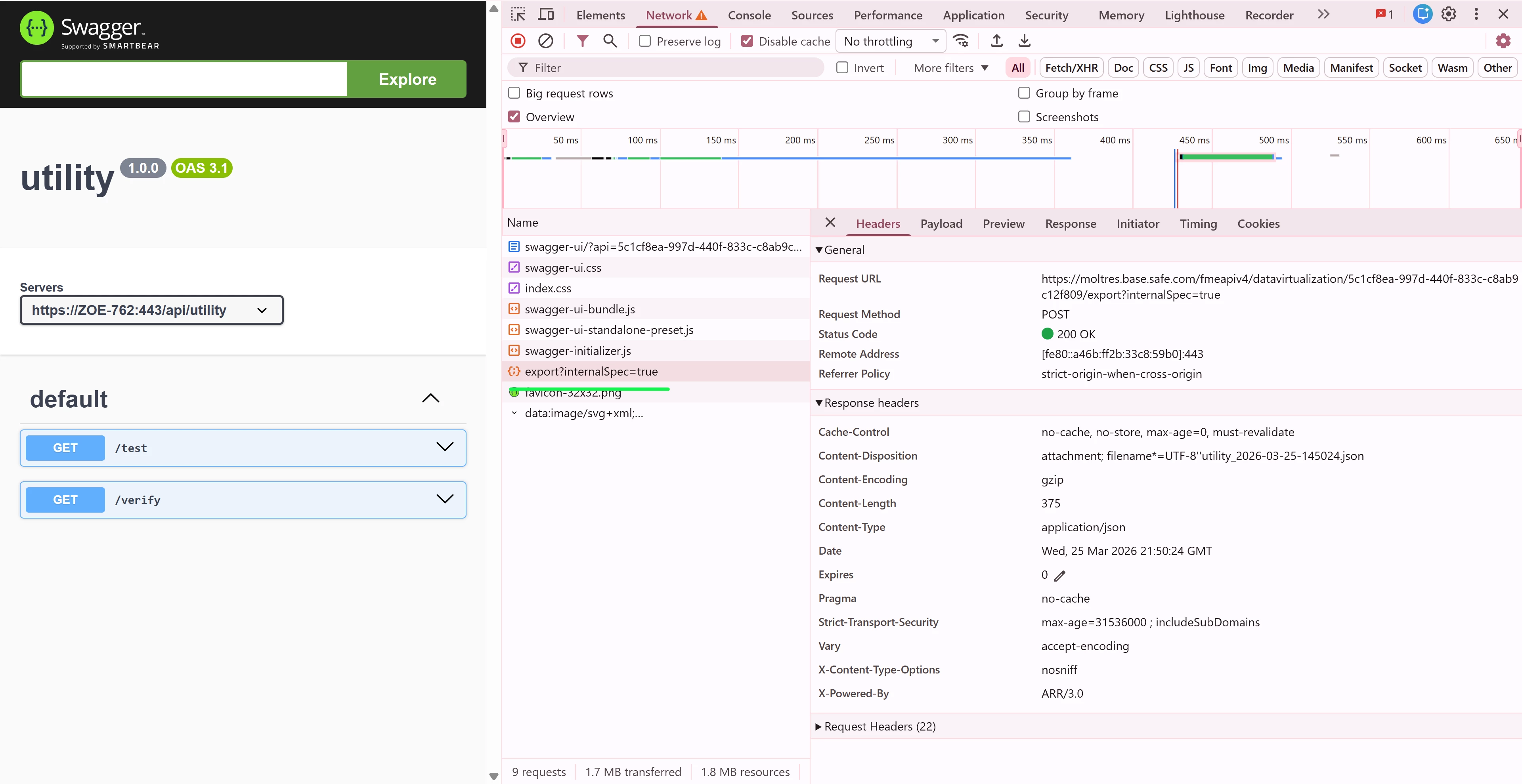

Could you please send the following:
  • A screenshot of the Swagger page when you try and open the docs.
  • A screenshot of what’s shown when you press the yellow “Invalid” button.
  • Screenshots of the POST /export endpoint in DevTools. The endpoint is unauthenticated so nothing confidential should be here (and session tokens are short-lived), but I recommend hiding the request headers just in case:

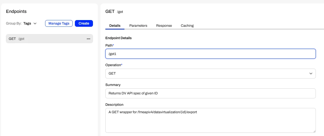

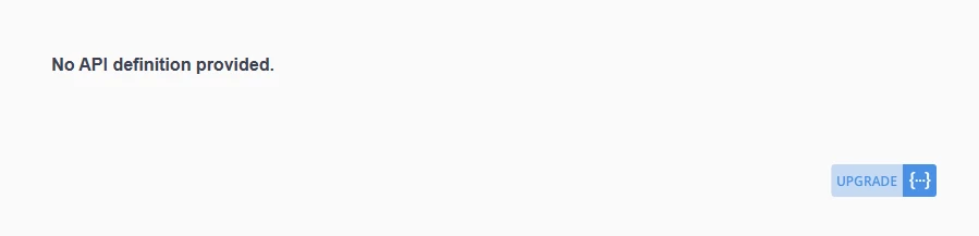

Hi,
I changed a few things to test this:
  1. Changed the get-endpoint of the api-spec from get to get1 to see what happens. (I did not remove the whole API-spec DV to avoid having to go through the steps again and you cannot temporarily disable a DV I think). As soon as I do this, I get the message from the second screenshot. So not the original Invalid button, but at least it shows that it is not working properly.
