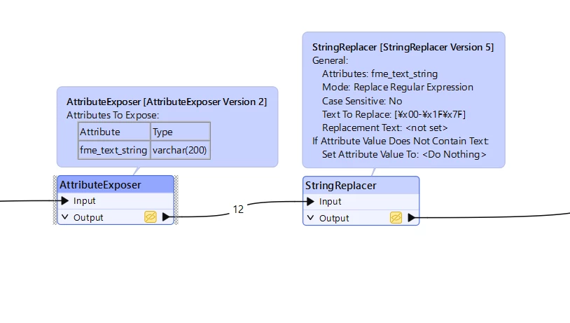

After further investigation, I confirmed that the issue was resolved in this file as well as in another test file.
It appears that the text was not completely unrecognized; rather, some characters were partially rendered as tofu. This led me to suspect that unexpected control characters or invalid data might have been included in the stored text strings.
Therefore, I applied a StringReplacer with the regular expression [\x00-\x1F\x7F] to automatically remove any potentially problematic control characters, and confirmed that this eliminated the tofu output.
Please note that this is only one possible cause. Similar issues may still occur depending on the data, so I would appreciate it if you could regard this simply as one example case.
