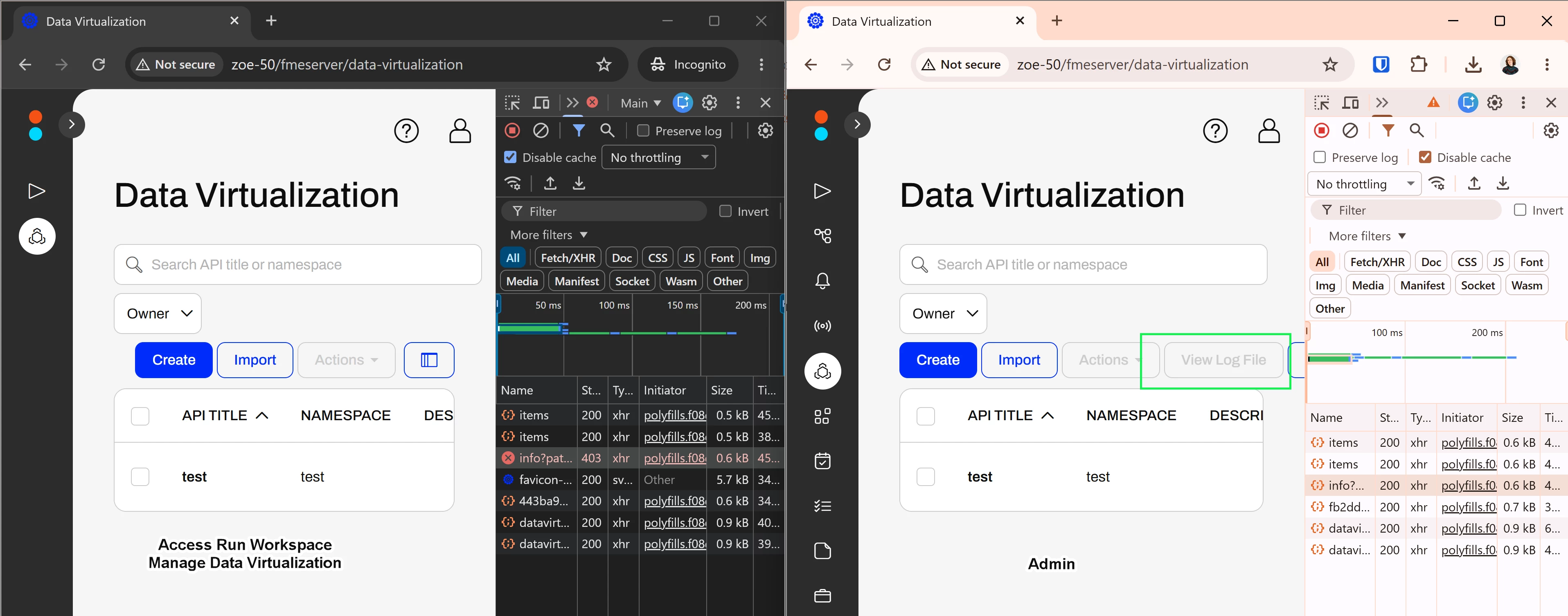

Unfortunately having gone through this a couple of times with our platform team (I’m no longer on the admin/superuser side at my current org) we get this error:
When loading the Data Virtualization page I get a 403 error involving fmeapiv4/resources/connections/FME_SHAREDRESOURCE_LOG

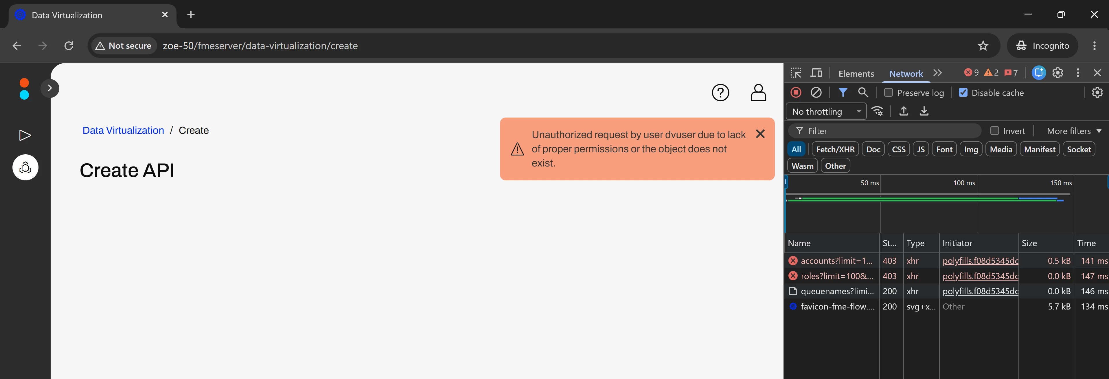

Then when clicking Create API I get another 403 error either involving fmeapiv4/roles or fmeapiv4/accounts - that coincides with the error flag/screenshot above.
I am hesitant to post any further URL details but I hope this gets you started.

​@chriswilson Thanks for letting me know. I installed your build and can see the failing log request is expected, and determines whether the View Log File button is displayed:
Seeing an error popup here is not expected however - let me know if you see this.

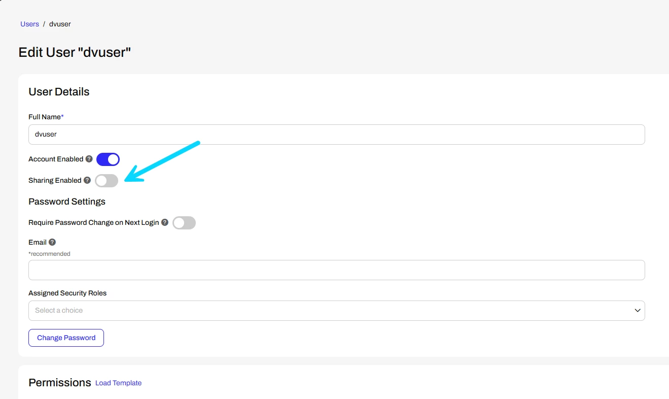

When creating an API, I’m able to reproduce a blocking error which I think could be what you’re seeing:
While I believe this is a bug which I’ll report, this only occurs when Sharing Enabled is unchecked in the user’s settings:

​@zoe.forbes that was it, enabling the sharing option removed the error.
