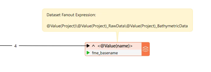

Hello ​@francesca.corp1, it should be possible to fanout CSAR datasets to a valid directory structure. Can you share how your writer and writer feature type parameters are configured? I think I was able to mimic the expected output directory with the following configuration:
Let me know if its correct or not, and we can change it as needed! Happy to help, Kailin.
