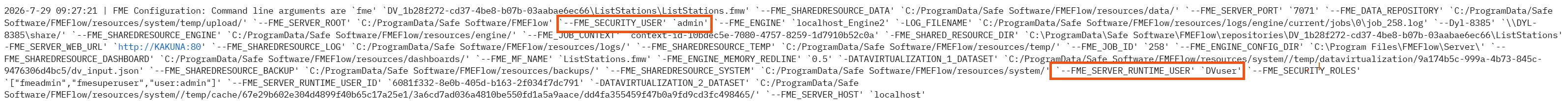

Just to be clear, There’s a difference between the user account the workspace is running as and the user who is allowed to trigger the end point.
e.g., FME_SECURITY_USER vs FME_SERVER_RUNTIME_USER (take a look in your log file)
FME_SECURITY_USER is the one that needs the permissions to do stuff. This is the one who needs access to the database connections for example. The FME_SERVER_RUNTIME_USER is the user who triggered the process. The user who triggered the process does not need to have permission to access the connection.
I think the FME_SECURITY_USER is the owner of the DV service.
You can create a user with 0 permissions and then assign them to the end point. They can trigger the process, however, it will be the owner of the process which access anything it requires.

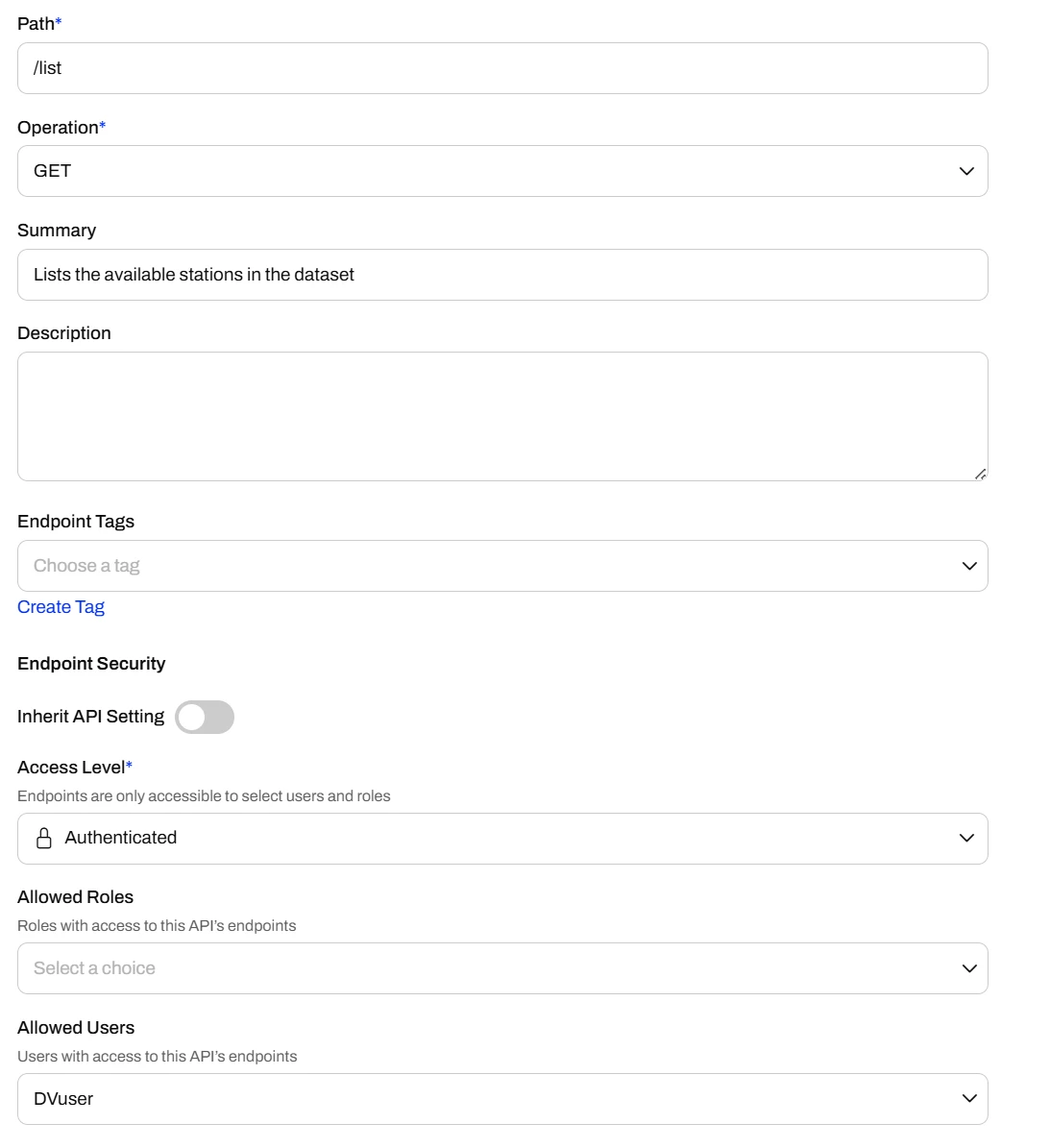

Thank you ​@itsmatt for the detailed response! To add to Matt’s explanation, you don’t actually need to give the owner/creator of the API permissions to run it. For example:
An API is owned by the admin user
But we only allow a user called DV User to run the endpoint

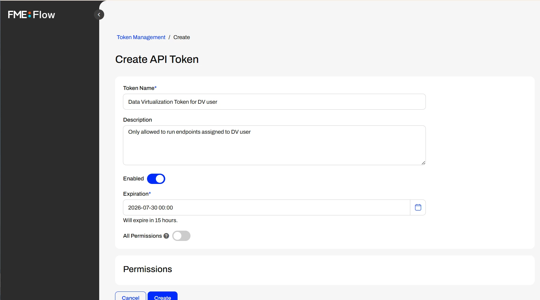

DV User has no permissions, but is still able to create tokens

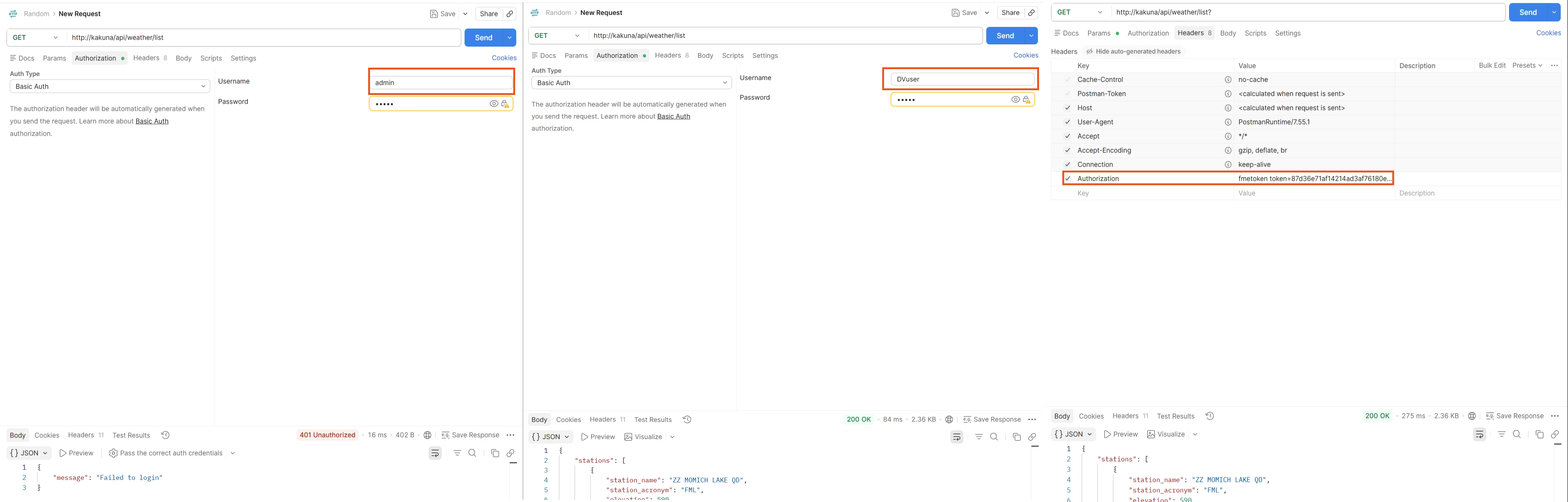

Testing in Postman, we can see the DV User basic auth and token work, but using admin credentials does not

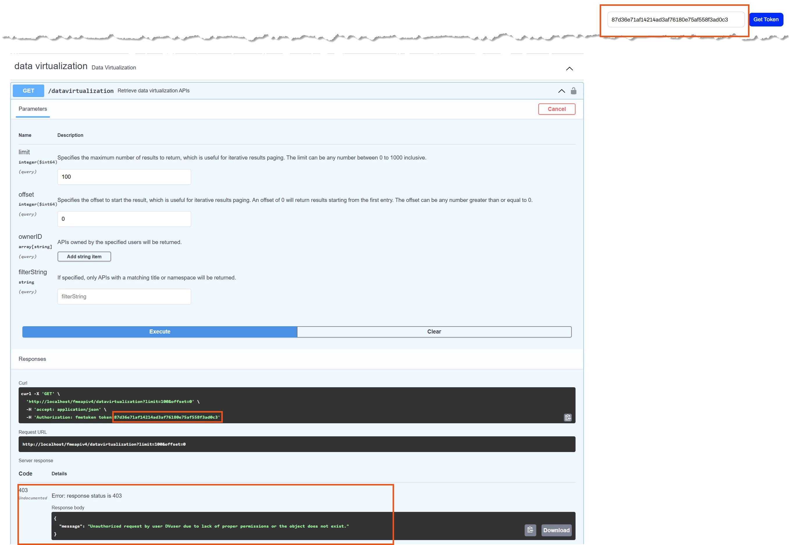

As Matt mentioned in the job log, we see the owner (admin) as the Security user and the runtime user as the DV User
If I navigate to the REST API documentation page and set my DV User’s token as the global token, I can confirm this user does not have permissions to anything else, including the Data Virtualization REST API. It can only run the specific endpoints it has been assigned to.
