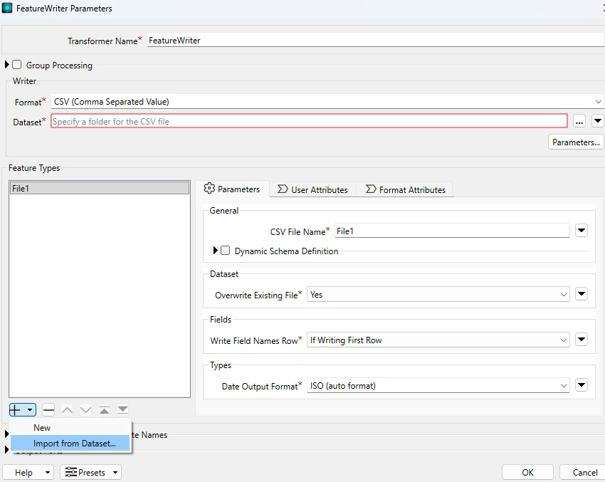

Another option, on the writer is to “Import from dataset”, where you specify csv and select the original file to define the user attributes (manual).
Import from Dataset onto a feature writer
 Once you have the user attributes imported, then you make a connection to the data stream and check all the incoming attribute names match that of the destination (attribute mapping)
