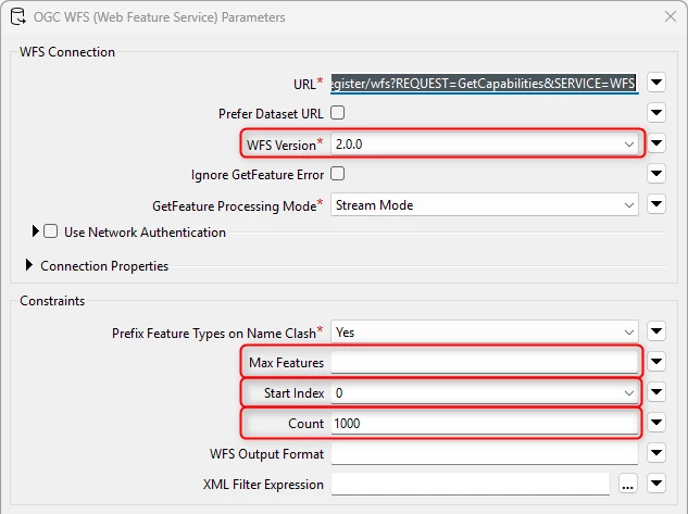

When I try to replicate this it continued past 10.000 features. I stopped at 90k. My settings:
You probably want to set count at a higher number. 10.000 does also work, less overhead.

OMG it worked! It was the “count”.
Thx :-)
