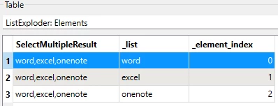

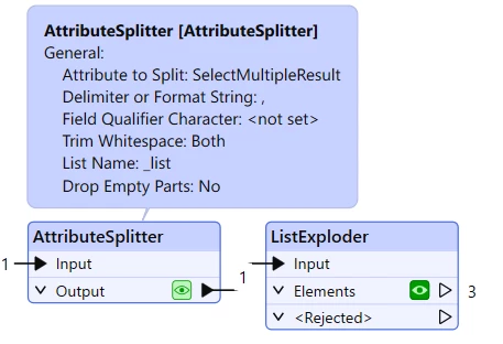

AttributeSplitter; set the delimiter to , a comma > List Exploder set to the _list from the last transformer
sample data
transformers
Result:
sample data
transformers
Result:

Thanks for this response, this seems to have worked!
