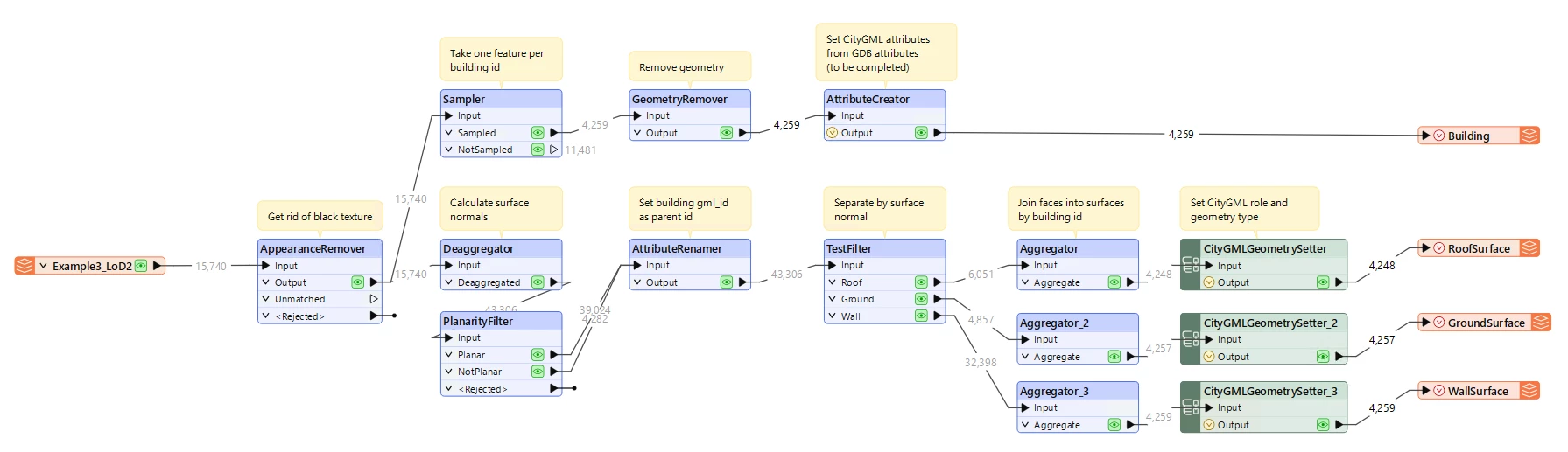

I’m currently struggling to figure out how to convert a LOD2 3D-Multipatch from a FileGDB into CityGML. I do currently not have a program avail
able to open or edit CityGML files, but it might be important at a later stage to be able to convert the data back into CityGML. Is it generally possible to convert any multipatch into a CityGML file at a later stage, or is important information lost in the process?

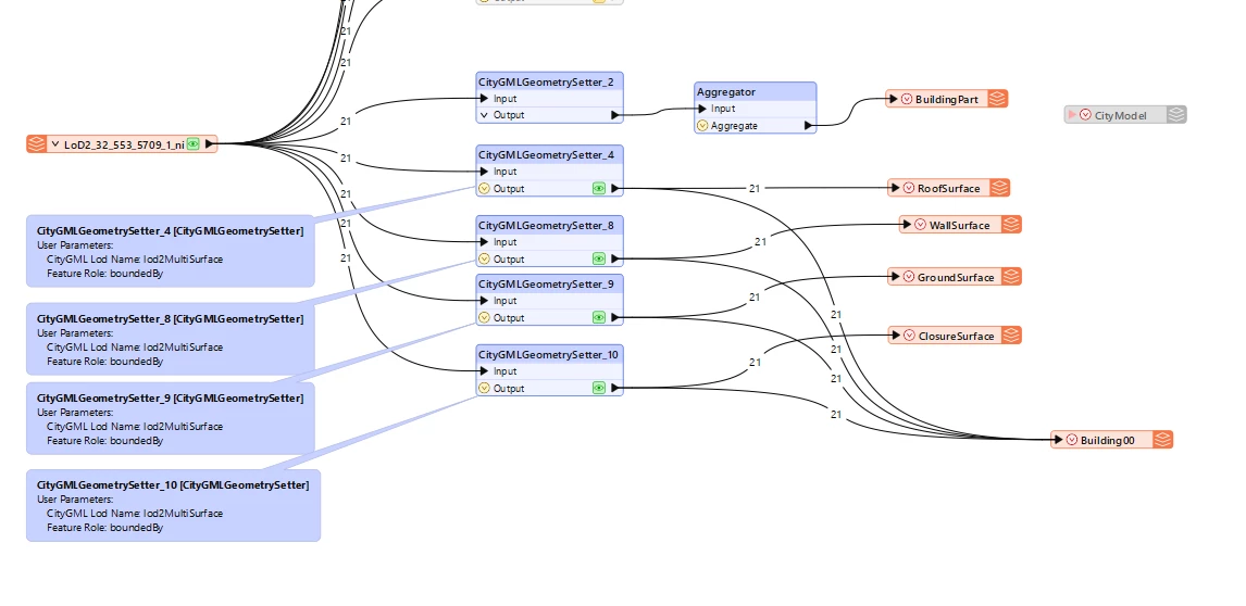

How do I ensure that a distinction is made between Wall, Roof, Ground, and Closure Surface? Or is it all simply classified as Building?
I've already looked at the website Writing CityGML from FME, but unfortunately, I still don't know how to proceed. How do I know which ‘citygml_lod_name’ value to use? If multiple values ​​yield a result, should I use all of them parallel?
I would be grateful for any tips to help me understand this better…

My first attempt of a workbench...

Hi ​@melri
Please try the attached workspace. It uses the surface normals generated by the PlanarityFilter transformer to distinguish between Roof (normal Z component positive), Ground (normal Z component negative) and Wall (normal Z component 0) surfaces.

Hi ​@daveatsafe,
many thanks! The workbench helped me a lot understandig how to distinguish between Roof, Wall and Ground Surfaces.

Hi ​@melri,
When adding the CityGML writer in the workspace, set the Add Feature Types option to ‘Import from Dataset’. When the Import Writer Feature Types dialog comes up, leave the Dataset blank, then click OK. This will import all the possible CityGML feature types with their normal attributes already defined on them. Then you just need to ensure that you set a value on the features within the workspace using an AttributeManager to populate them when writing.
If you want to add your own attributes, you can double-click on the output feature type and modify the User Attributes to include your custom attributes.
The CityGML format is hierarchical, but in FME we are working with it as a relational model, setting the hierarchy links using gml_id and gml_parent_id attributes to establish the hierarchy. So some complex attributes like Address are modelled in FME as feature types. Importing all the feature types when adding a writer will show you all the possibilities for the output.
