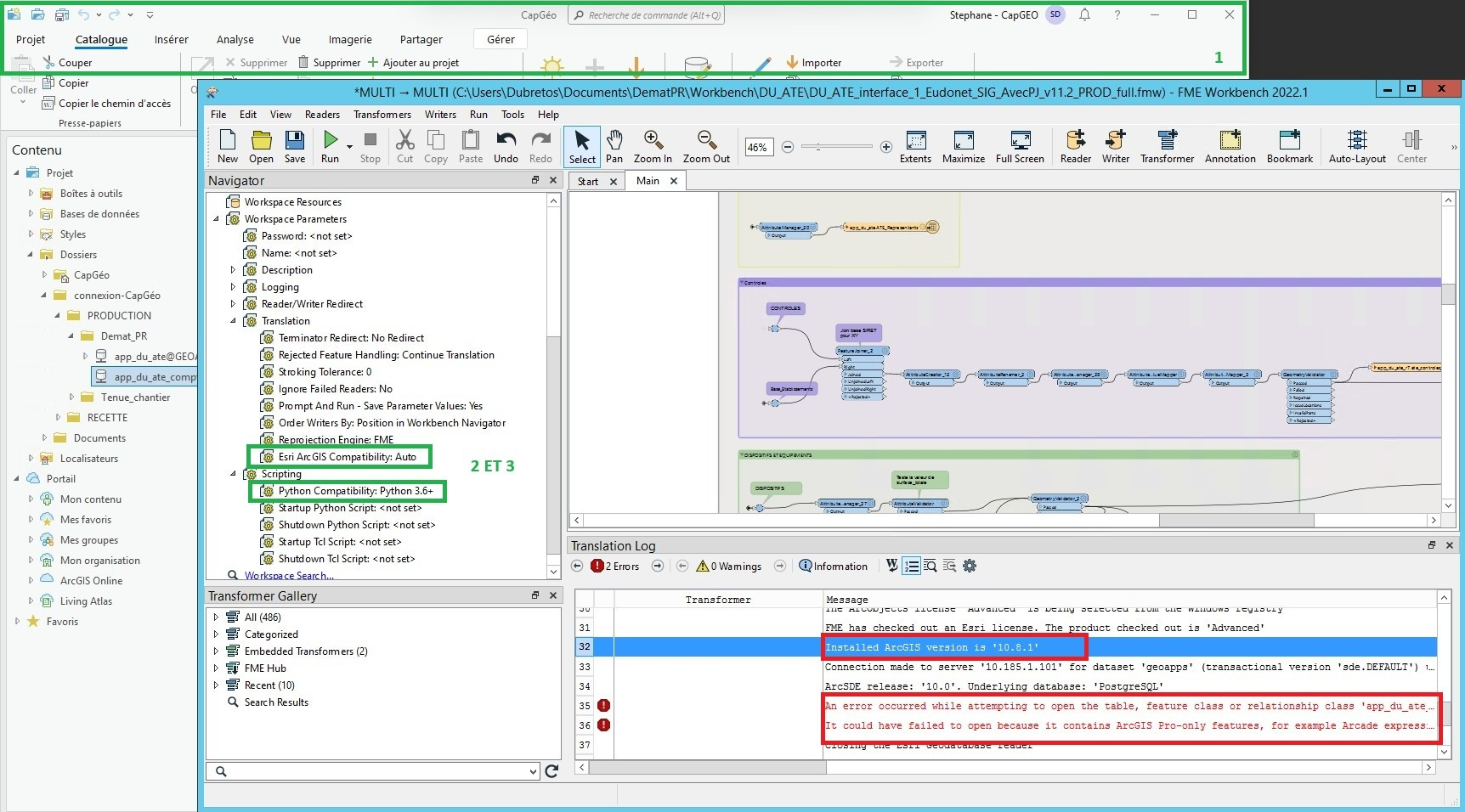

I’am using FME Workbench 2022 with ArcGIS desktop 10.8.1 and ArcGIS Pro 3 on the same machine. When I try to load a feature class only compatible with ArcGIS Pro (containing arcade expression), FME continues to use ArcGIS Desktop 10.8.1 librairies despite the transation / Esri ArcGIS Compatibility set  to Auto or ArcGIS Pro.

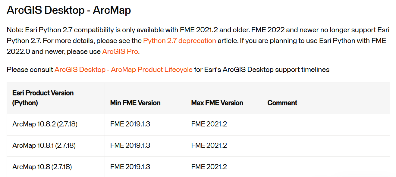

Hi ​@sdubreton That can be confusing. I would double check versions with the FME guide.
Notes on FME and Esri Versions and Compatibility – FME Support Center
Hope that helps and good luck with this!

Hi and thank you very much ​@crutledge .
After upgarding to ArcGIS Pro 3.2 the Workbench is now able to read and update the feature class in the argcis enterprise database without any problem.
